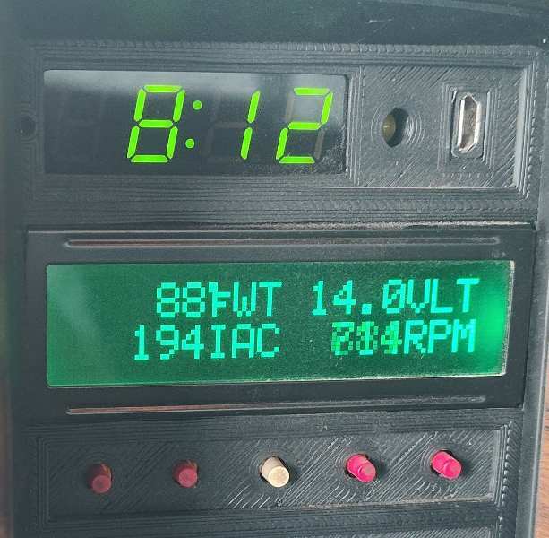

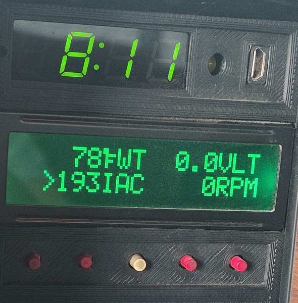

Eagle_SX4 Posted Thursday at 02:41 PM Posted Thursday at 02:41 PM Does anyone know why my REM shows 0.0 volts with the key on engine off, but 14.0 volts when the engine is running? Edit: With the engine off my battery measures 12.7 volts with a digital multimeter.
Ωhm Posted Thursday at 03:16 PM Posted Thursday at 03:16 PM Fuel pump timeout. 2-3 seconds after KEY ON without CRANK.
Eagle_SX4 Posted Thursday at 07:53 PM Author Posted Thursday at 07:53 PM Okay, I can see the voltage flash for less than a second after the REM boots up.
