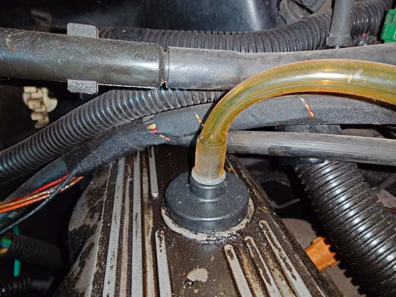

1/4" Vinyl tube fits over the plastic fitting on the rear of the valve cover.20260509_094151937.JPG.7fbb105775e9d663cbbc4a16fb35aaf9.JPG

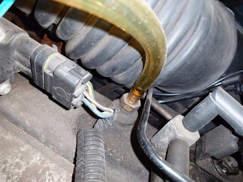

The tube also fits over the fitting on the intake manifold.20260509_094203724.JPG.0384ec360339fdc1b0d0ef027d9534f9.JPG

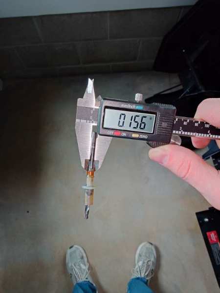

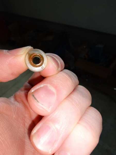

I had drilled out the plastic fitting in the rear of the valve cover to 0.156.20260509_094314990.JPG.ed061f1f8e487f8d4463c182600109f9.JPG20260509_094444348.JPG.525d326f3e5d126c205cbc554d5a314a.JPG
