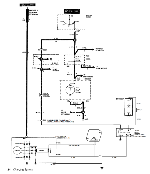

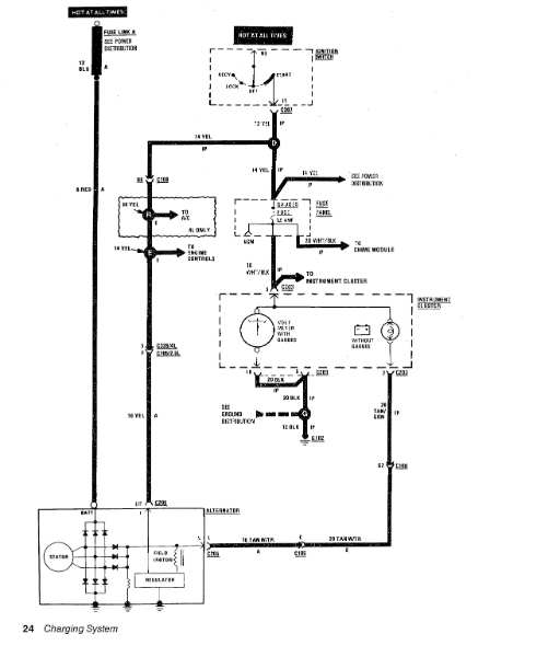

From this (p.24 1988 Electrical Manual):

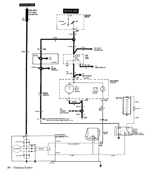

To this:

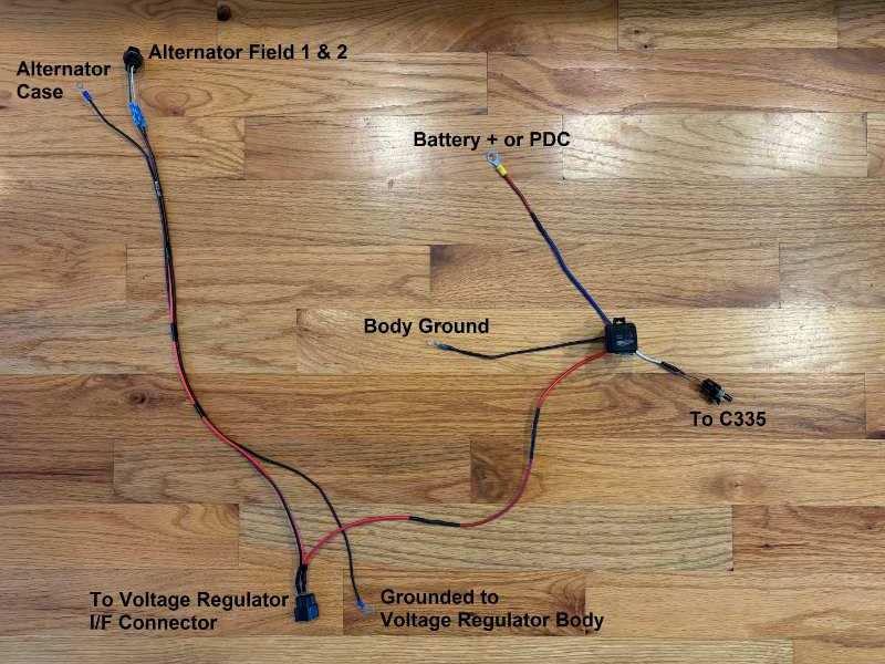

Complete external voltage regulator harness example:
Harness Explanation:
All lights pulsing at idle - common issue when doing this swap! The yellow field wire on the original alternator connector is usually the indicated switched 12V source. However, it comes all the way from the ignition switch, through Splice D, through bulkhead C100, through Splice R if you have A/C, through Splice E, through connector C335, and finally to C205 at the alternator. This is a run of about 10-11 feet! Plenty of noise and voltage drop opportunities. @NickInTimeFilms and a buddy of his did this swap in a YouTube video:

This 89 XJ already has the 91-98 A/C compressor bracket due to a previous HO-era A/C swap, and they're ditching that in the video, but that's not the point. The wiring is (11:24 - 18:12). In the comments someone asked if the lights pulsed at idle, and @tylermus replied that he'd added a relay next to the battery to eliminate the issue. So that's why I did this, and it worked great.
There also needs to be a ground wire from the regulator body to body ground. I added a large ground on the passenger side to mirror the one on the driver's side fender well (G106), so I tied into that. The 20A fuse between the relay and battery is optional, I did without.
I unplugged C335 and tucked away the side for the alternator harness. Rather than cut anything, I headed to the local boneyard looking for 88-94 Chevy TBI V8 trucks. It's the brown wire connector you unplug when setting the distributor base timing on those trucks. On the firewall under the PDC cover if the truck still has it. I got the Field wire 1&2 connector from a random Jeep/ Chrysler vehicle a while back, don't recall exactly which (easy to find).
External Regulator kit is from Alternator Man / alternatorparts.com, kit ERCK. Setup and explanation video from the Alternator Man himself here:
https://www.youtube.com/watch?v=utXjxwPAcHk
One more note: if you have a "Standard"/ dummy instrument cluster, you'll need to figure out how to wire the Lamp wire. I'll look into it and update this thread with how-to when I have time.
UPDATE: I'm 90+% certain this is correct for trucks with the "Standard"/ indicator light cluster.
