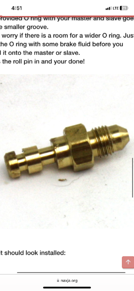

Everz Posted January 16 Share Posted January 16 can't seem to find just the fitting anywhere or how to properly identify it, I know its -3an on one side… any help would be appreciated Link to comment Share on other sites More sharing options...
Eagle_SX4 Posted January 16 Share Posted January 16 It is a available from advance adapters. https://www.advanceadapters.com/5046 The description says YJ but it does fit the XJ/MJ master cylinders as well. I am using it in my truck. Link to comment Share on other sites More sharing options...
Htchevyii Posted January 16 Share Posted January 16 The kit that I bought form Advance Adapters had two or three different fittings in it and came with the line. Link to comment Share on other sites More sharing options...

Htchevyii Posted January 16 Share Posted January 16 46 minutes ago, Everz said: seen that whole kit on quadratec but not looking to replace everthing again. appreciate the help For sure, I remember looking at the individual adapters on the AA website, but the application guide was so vague, it was hard to tell which one was correct. Here's a list of their PN's for the fittings in the kit, not sure which one is correct for the MJ though? JEEP SLAVE CYL KIT FOR JEEP NV3550 AND AX15 BELLHOUSINGS CHRYSLER 52107640S Bill Of Materials 5/16 -18 X 1-1/4 H.H.C.S. / 723134 HOSE-60 STAINLESS -3 FITTING / 716130-60 FITTING -3 MALE TO MALE 7/16-24 INV / 716130F FITTING- JEEP YJ MASTER CYL / 716130 JEEP SLAVE CYL /NV3550 BH / 716341 FITTING JEEP TJ MASTER CYL. / 716130TJ Link to comment Share on other sites More sharing options...
Eagle_SX4 Posted January 16 Share Posted January 16 The fittings needed for the -3AN clutch line from Advance Adapters are 716130 (for the master cylinder) and 716130TJ (for the slave cylinder). The clutch line is part 716130-60. *These parts only work with the 91+ master cylinder and external slave cylinder. Link to comment Share on other sites More sharing options...
