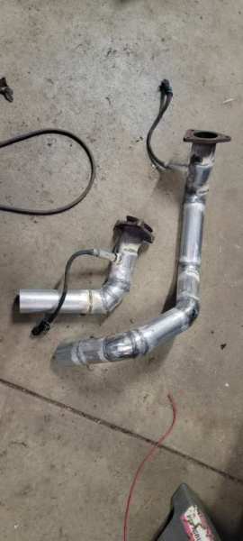

The exhaust tubes got fully seam welded, retained some old sensors to keep the threads clean.

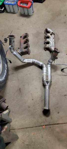

Then along came the test fit which was a complete success soo the 2-1 collector got tacked to the down pipes. Complete Y-pipe for this swap is essentially done!

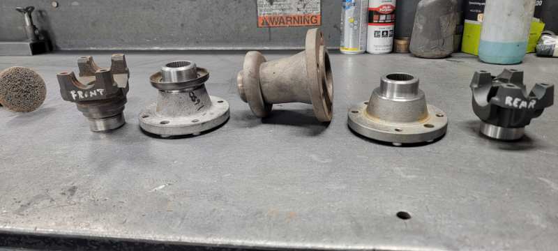

The new yokes are here. Did a similar thing with my other FSJ build and 241 tcase. Turned down some old 205 flange yokes to match the install of this factory front yoke and the aftermarket yoke that came with my sye kit.

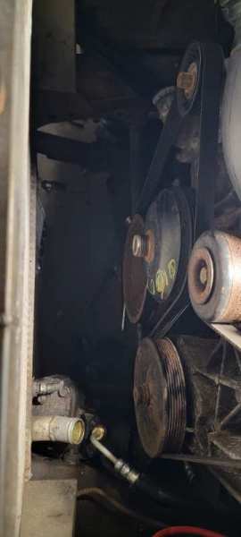

Last little bit is finally resolving this lower rad hose ordeal. The factory radiator lower hose is routed up - right into the LS steering pump pulley. This makes it challenging to find or fit a hose with a gentle bend to then go towards the passenger side - its awkward!
My solution is going to be chopping the tube off and clocking it 90° in to the flow towards the passenger side. Simple enough deal, it will still clear the steering gear and eliminate the need of an awkward bend.20251221_172023.jpg.b20b4da093991f89aa55ed8e62fea519.jpg

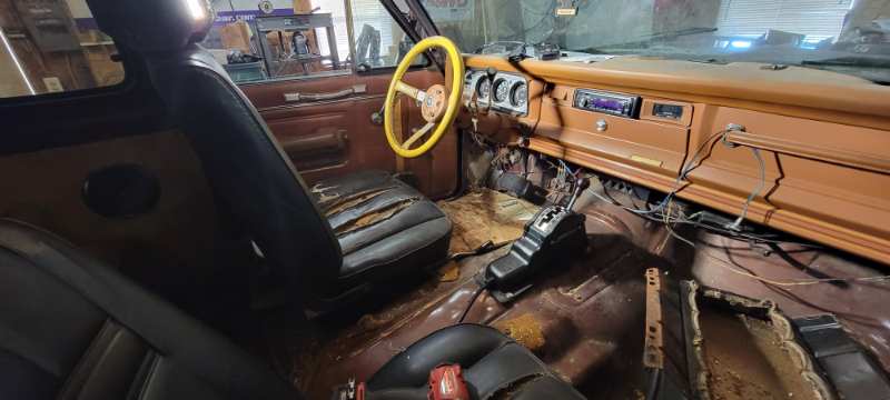

My only sharable progress is the winters gated shifter i installed.
