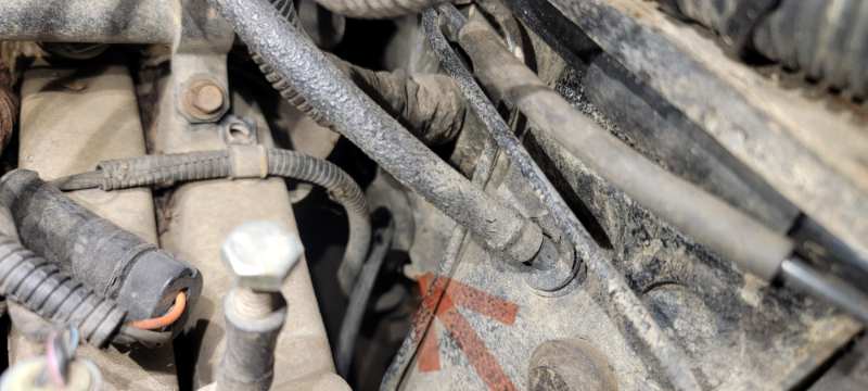

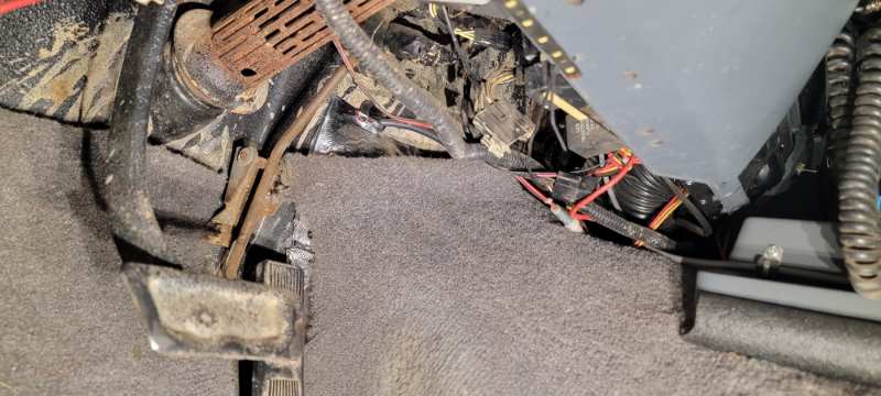

Ken Seymour Posted July 21 Share Posted July 21 I'm almost done with my truck. I'm changing my 87 Comanche to a floor shifter. I put a full gauge cluster in and I can't modify the panel for the column shift gear indicator. The question. Are there two different floors. One for column and one for floor? There's a black plug in my floor but it's on the passenger side of the hump. I have a dimple on the driver side but it's not cut out. Cory at Jeep Cemetery doesn't run into automatic transmissions often and can't tell me where the shift cable is supposed to go through. I have the 87-90 cable with the rubber seal on it. Any help greatly appreciated. Link to comment Share on other sites More sharing options...
eaglescout526 Posted July 21 Share Posted July 21 I think there’s a hole under the lower air vents. I recall seeing something like a hole that was plugged when I had the vinyl floor out of my XJ. Link to comment Share on other sites More sharing options...

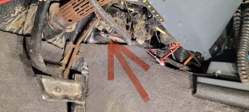

ThatJeepGuy Posted July 21 Share Posted July 21 Floor shift cable would run through the fire wall just up and to the right of the gas pedal Link to comment Share on other sites More sharing options...
ThatJeepGuy Posted July 21 Share Posted July 21 Now with arrows Link to comment Share on other sites More sharing options...
Ken Seymour Posted July 21 Author Share Posted July 21 Found out what went wrong. I have the wrong cable. I needed the long one. That Jeep Guy. Thanks for your pictures. Thanks everyone. Link to comment Share on other sites More sharing options...
