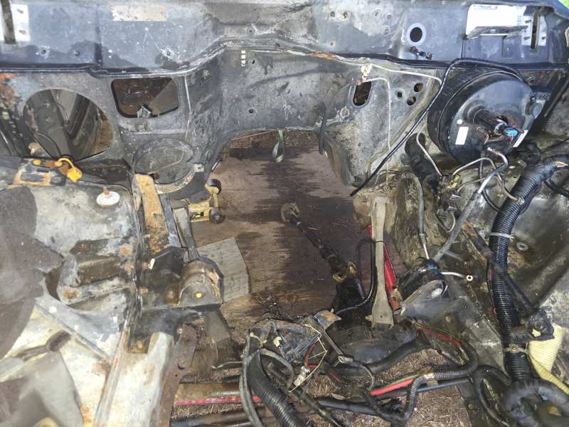

Jacoop91 Posted 8 hours ago Author Share Posted 8 hours ago 6 hours ago, ghetdjc320 said: Also, did you swap the actual frame side mounts from the XJ onto the MJ? I’ve found it to be a much easier process to install the engine with tranny assembled then add the transfer case Yep, I removed the 2 side mounts from the donor XJ and the driver side seems to line uo perfectly, however the passenger side mount is roughly 1.5" closer to the firewall...at the time I figured maybe the mounting points on the 4.0 were slightly offset by that much, but now that I have the motor hoisted over it, thats not the case. Link to comment Share on other sites More sharing options...
89 MJ Posted 8 hours ago Share Posted 8 hours ago 5 minutes ago, Jacoop91 said: Yep, I went back and forth on whether or not to leave it attached tp the motor, and I decided to remove them separately Ok, good. Just wanted to double check that you were using the proper transmission. It is usually easier to do them together, but installing them separately is fine too. Could you post some pictures of what is going on? Link to comment Share on other sites More sharing options...
Jacoop91 Posted 7 hours ago Author Share Posted 7 hours ago 22 minutes ago, 89 MJ said: Ok, good. Just wanted to double check that you were using the proper transmission. It is usually easier to do them together, but installing them separately is fine too. Could you post some pictures of what is going on? Sure thing, I'll be home in just a little bit and I'll get right on that. I'm already feeling a little better just having someone to talk to about it I really appreciate it Link to comment Share on other sites More sharing options...
89 MJ Posted 7 hours ago Share Posted 7 hours ago 8 minutes ago, Jacoop91 said: Sure thing, I'll be home in just a little bit and I'll get right on that. I'm already feeling a little better just having someone to talk to about it I really appreciate it Sounds like a plan. Everyone here is always a great help! Link to comment Share on other sites More sharing options...
