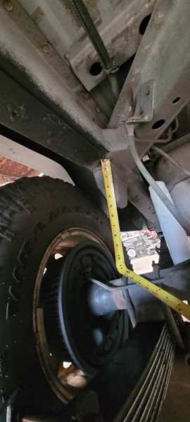

What I need is the stock measurement from the top of the axle tube to the bottom of the frame, like so:
I'm currently right at 12" after I put longer shackles on... with the stock length ones I was at 11.25".

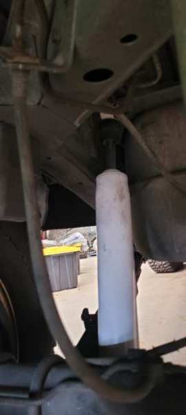

My shocks I ordered from Rocky Road Outfitters for a 6" lift are nearly fully compressed:

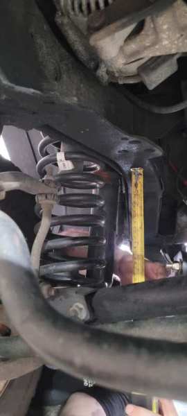

Front spring info:
11-¾" from top of axle tube to bottom of frame on Old Man Emu coils.
This tracks with my buddy's MJ which has Metacloak 3.5" lift dual rates and he measures 11" in the same space.

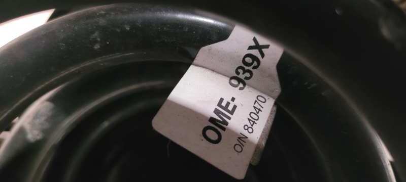

Here's the model of my coils:
I found this thread to be helpful. Extracted from M.R. 277. There is a +1" difference in factory ride height front and rear for 4WD models.
6" lift for a 4WD model would be 13.75" front and rear would be 15.2". It's also my understanding that the factory rake (rear height > front height) is about 2 inches, with these measurements equally changed with lift (or sag).
Quick numbers - your lift is:
2.8" rear
4.0" front
Which gives you .8" of rake R > F, so it looks almost level, with the weight of the topper probably not sagging it at all with those beefy leafs.
