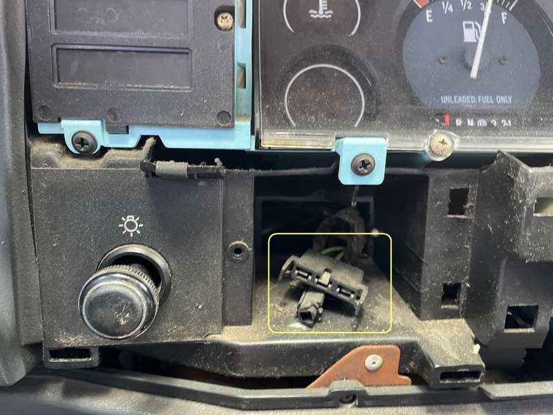

AnotherOldJeepGuy Posted June 29, 2025 Share Posted June 29, 2025 Just swapped out my radio and I snapped the pic below of extra wired connectors behind the dash trim to the right of the light switch, and wondered what they are for. Would they be functional, ie, could I connect up what goes there and have functional, whatever goes there, stuff? Link to comment Share on other sites More sharing options...
fiatslug87 Posted June 29, 2025 Share Posted June 29, 2025 There should be two of the large flat one, one is for the fog light switch, the other for the cargo light switch. The little round one takes a bulb that illuminates the fog/cargo symbol on the switch plate, should also be two of them. Link to comment Share on other sites More sharing options...
fiatslug87 Posted June 29, 2025 Share Posted June 29, 2025 Wiring is there for the cargo light (up to 1990??) look for a pink wire up high behind the driver side rear panel. Fog light wiring is there up to the 10 pin connector in front of the air box but you need a different headlight harness with the fog light wiring and relay. Link to comment Share on other sites More sharing options...
AnotherOldJeepGuy Posted June 29, 2025 Author Share Posted June 29, 2025 Ah thanks. Well shoot, I already have the dash back in so I'll have to look for the second set the next time I have that removed. Link to comment Share on other sites More sharing options...
