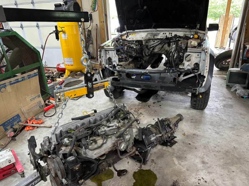

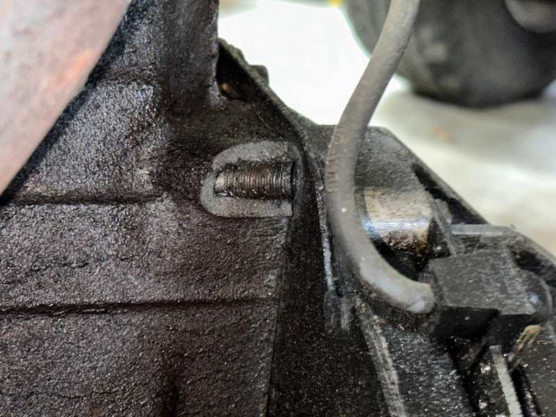

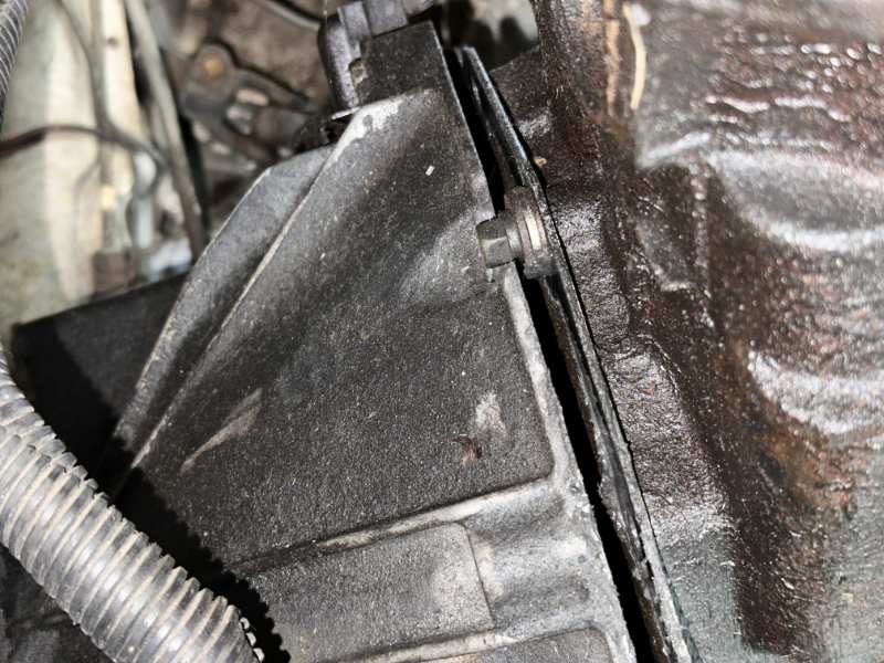

ThreeComanches Posted June 15, 2025 Author Share Posted June 15, 2025 So today I finally went out to the shop to get some work done. Finally managed to get the driveline out and it looked worse than I thought. The shop that replaced the engine in 2019 did a horrid job. That probably explains why said shop closed a month after they did my swap LOL. Bellhousing bolts were missing, the transmission bellhousing was cracked, and the engine block had a crack. Link to comment Share on other sites More sharing options...
89 MJ Posted June 15, 2025 Share Posted June 15, 2025 Wow! That’s exceptionally bad. Link to comment Share on other sites More sharing options...
ThreeComanches Posted June 15, 2025 Author Share Posted June 15, 2025 1 hour ago, 89 MJ said: Wow! That’s exceptionally bad. Tell me about it. It wasn't ever the same after the first engine swap. Dare I say it drove better before it was done. Link to comment Share on other sites More sharing options...
