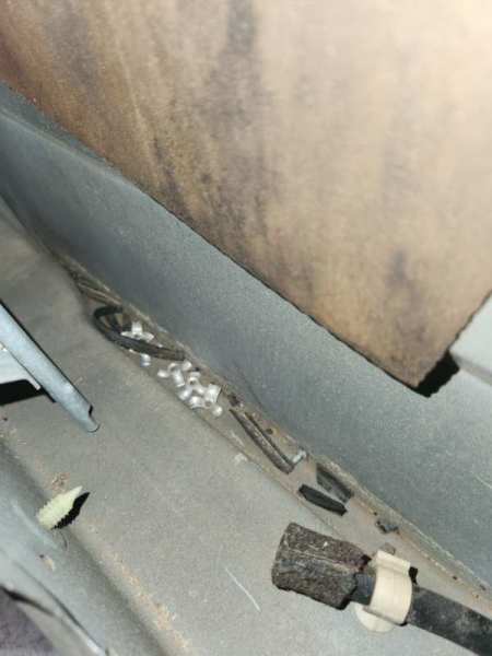

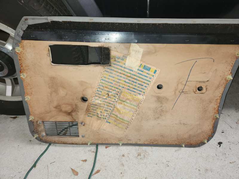

The driver’s door was the cause of most of the noise while driving. Given the hole where the door check should be, I expected that those pieces rattling around in there would be most of it. Also found that a repair had been done at some point and they just dropped all the trash inside, which didn't help. Pulling the door card I did find the build sheet mostly intact and with minimal moisture damage. So that was cool. The last couple rattles were fixed with some mesh cable sleeve and cloth tape.

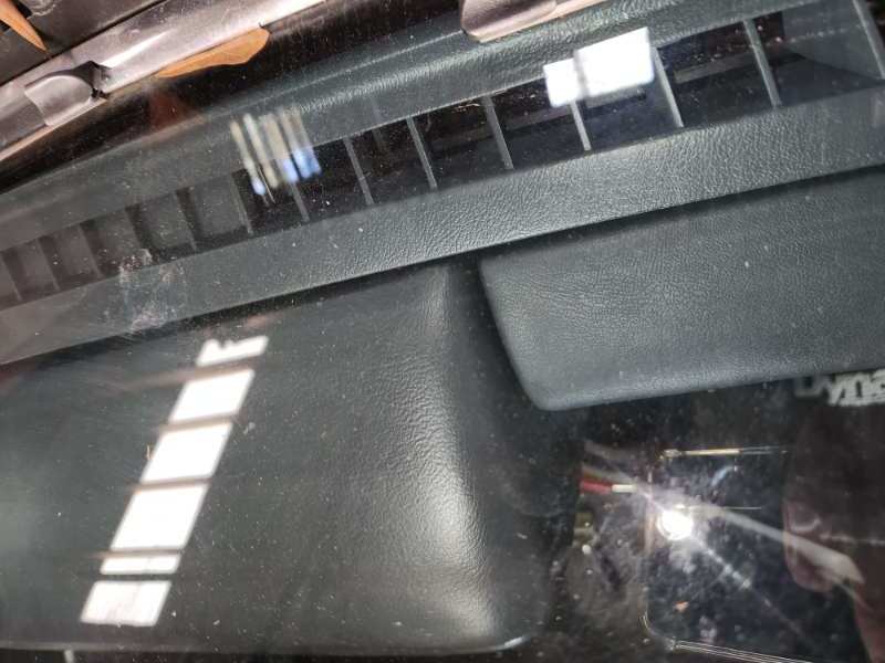

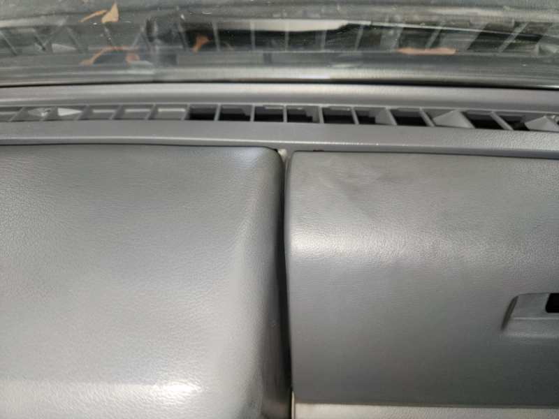

Finding a defroster bezel that matched the new dash proved impossible. They were all heavily faded / sun damaged. Found a spray
paint at HD that matched really well; ‘Orion gray’ by Behr. It only came in gloss so had to tone it down a bit with some satin clear. Really happy with the result. I think the color was discontinued unfortunately, as they didn’t have any when I went to buy some more.

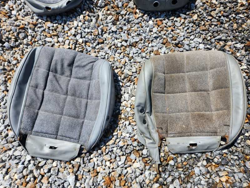

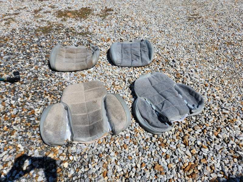

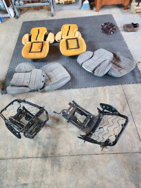

Got a deal on a set of actual Comanche buckets, so I won’t be putting the bench back in.

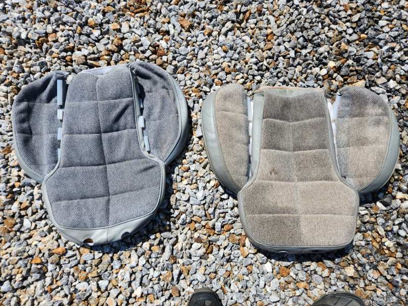

I know people talk about how well these cleans up but it really exceeded my expectations.
Used purple power and just the pressure from the hose nozzle and WOW. After that I ran them in the washing machine on delicate and hung them on the fence to dry. They look great.

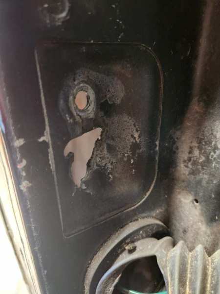

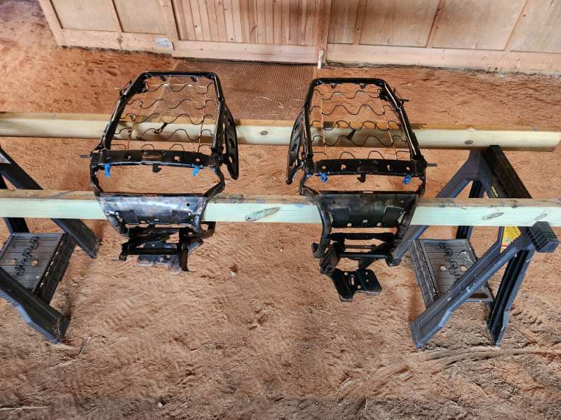

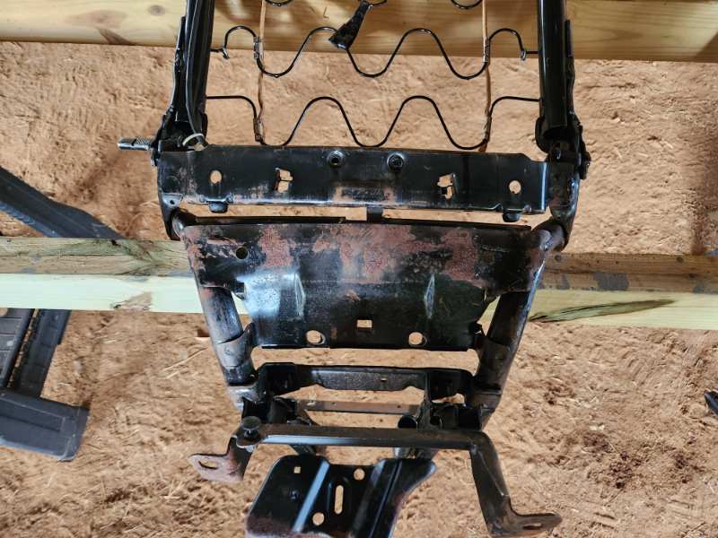

While they’re apart, I re-welded a couple spots that had popped loose. Going to remove the surface rust from the frames and hose them down with rustoleum before reassembly.
Heck yeah! Purple Power and a pressure washer for the win! :L:
