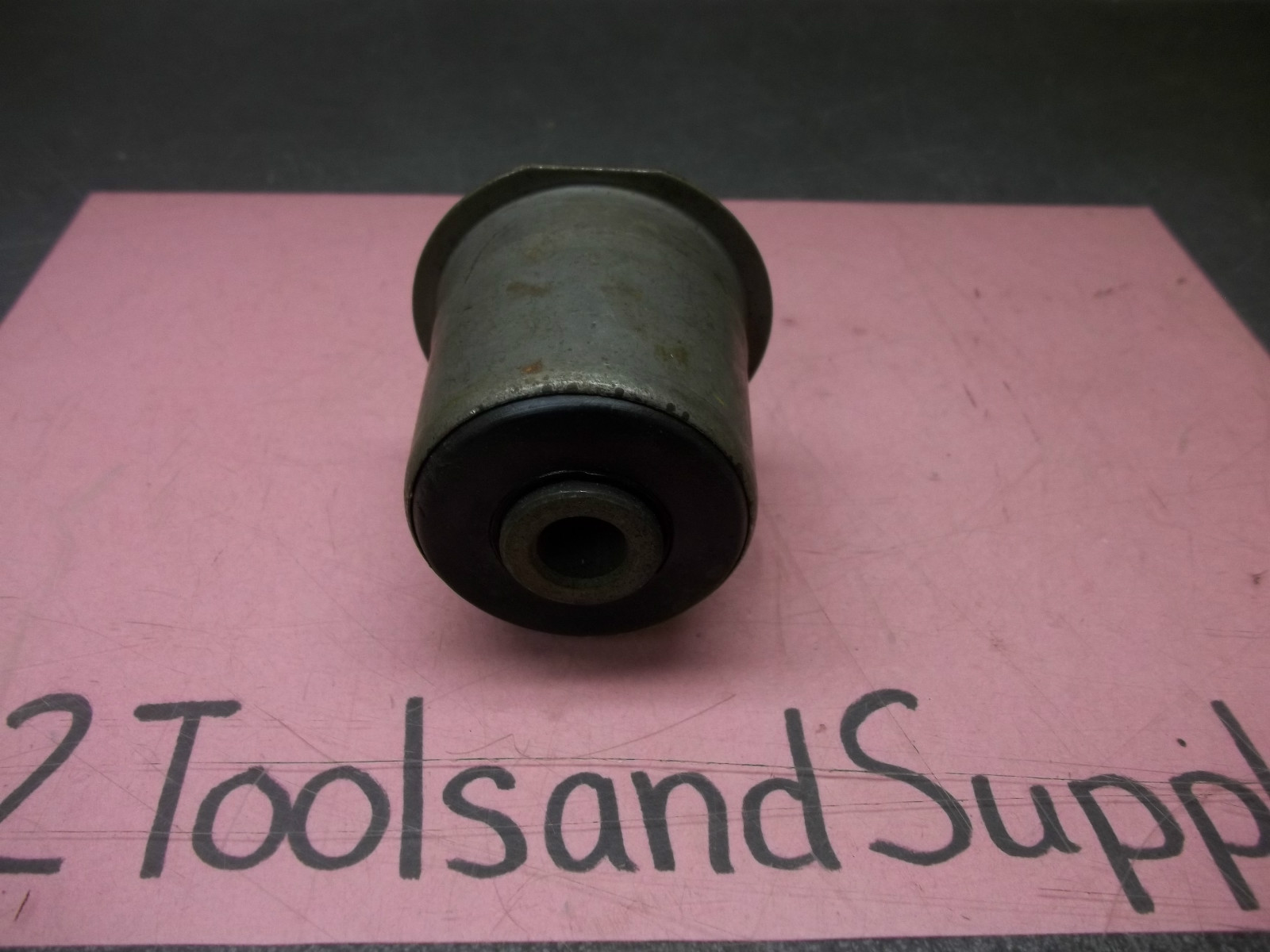

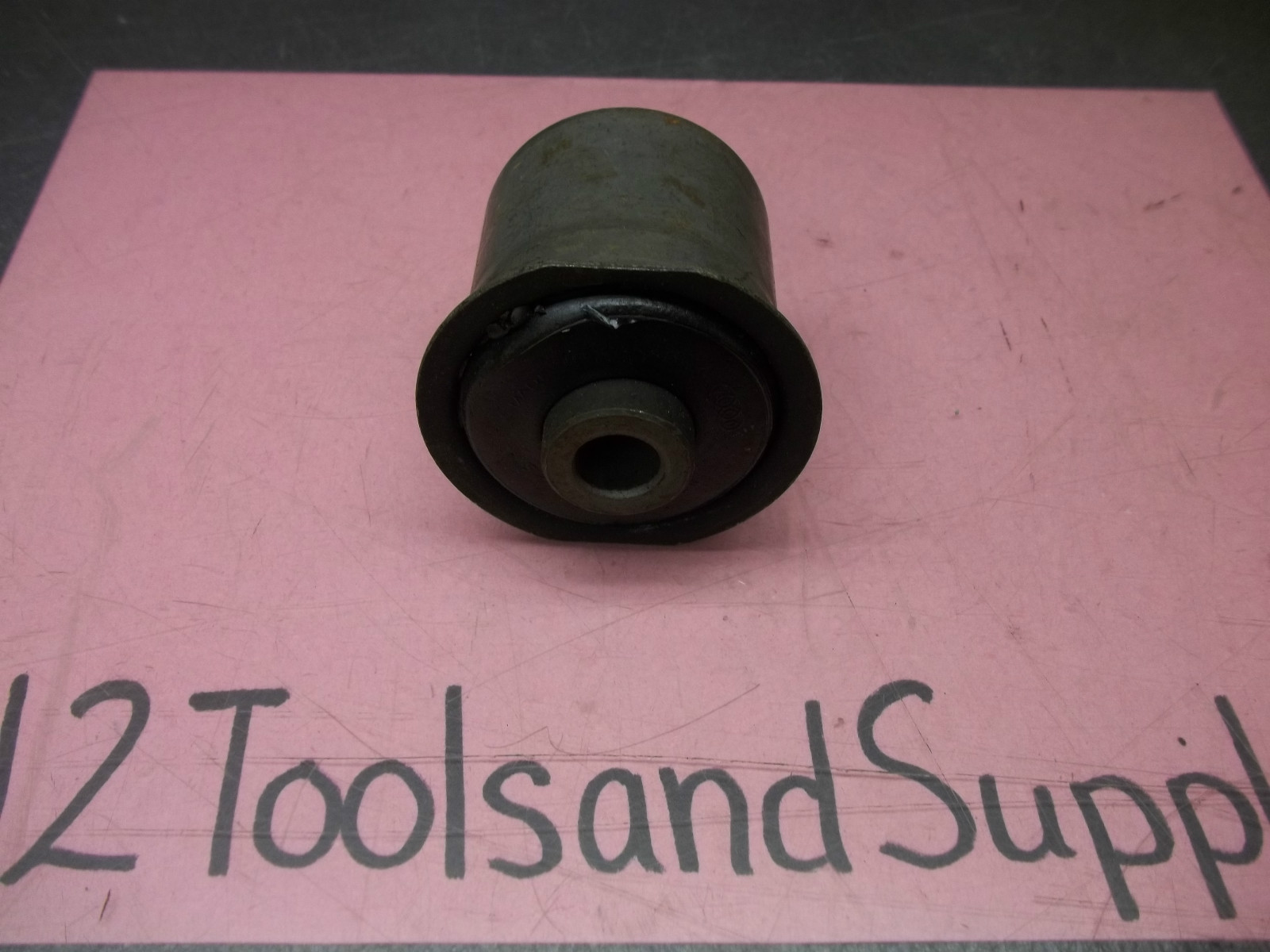

ScottJeep Posted August 22, 2015 Share Posted August 22, 2015 Those two bushing....they are...NOT the same. If you can show me how a ROUND bushing fits in a OVAL hole I'll be a believer but until then..... http://www.moparpartsoverstock.com/showAssembly.aspx?ukey_assembly=946884 #15 For the rear body side location. Now if does fit either arm but not either location. #3 Different part number.... which is surprising. Appears the the one bushing is even the axle side bushing on the 2WD axle.... http://www.quirkparts.com/oe-mopar/52088220 Link to comment Share on other sites More sharing options...
HOrnbrod Posted August 22, 2015 Share Posted August 22, 2015 http://www.ebay.com/itm/New-OEM-Mopar-52088220-Control-Arm-Bushing-/181210126316 Oval Round Link to comment Share on other sites More sharing options...
Strokermjcomanche Posted August 22, 2015 Share Posted August 22, 2015 . Link to comment Share on other sites More sharing options...
ScottJeep Posted August 22, 2015 Share Posted August 22, 2015 Stroker that is the picture... needed....... it REALLY SHOWS the two different bushings well... "One these things is not like the other...one these things it doesn't belong.... " oh sorry was just thinking of the ole days of Sesame Street when it was easy to see/show what the difference about items... Link to comment Share on other sites More sharing options...

ScottJeep Posted August 26, 2015 Share Posted August 26, 2015 I rest my case..... Yeah, round stuff.... oval ( really football ) hole. It does not go together. And there is your part number for the round end. This HERE. ....is not a set there is no oval bushing. And well yes I did...do some purchasing to prove a point. But I have thought about those WJ arms before. Thanks Don. You pushed me along. Link to comment Share on other sites More sharing options...
