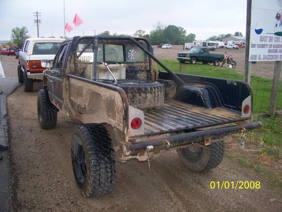

stroked 4.7L, D35 front ARB locker, 6.0" rustys offroad long travel suspention, D44 rear spool spring over axle,
costom axles & shafts with 4.11 gears, 35" mud rovers, frame 12" shortend, bedsides tubed 15" shortened,
cab full DOM cage inside, fuel cell and battary relocated to inside the bed,
WIP
radiator relocation into bed, electric waterpump installation, front fender removal/modification for tube installation,
brother's building a 400small block, talking subframe and motor swap, 4 wheel 11" disk brakes
future
D60 front, 12bolt rear, rear shakle swap to 4link, and finally 44's "one bite at a time" B..

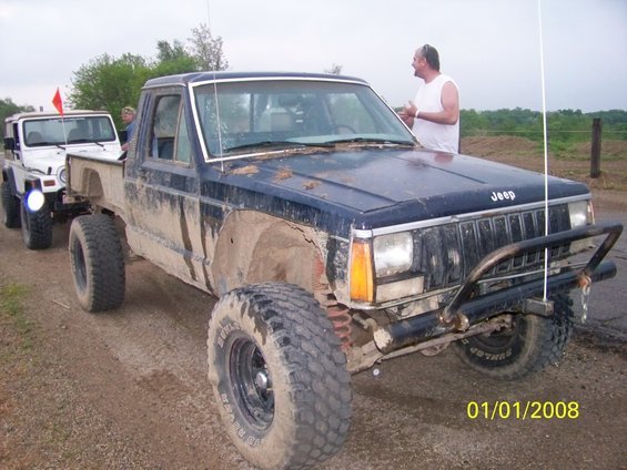

love the truck it looks great what kinda lift and motor and other specs does it have ? and she looks pretty dirty but good lol
