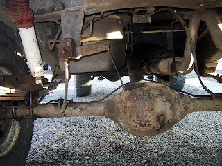

cracker Posted July 23, 2010 Posted July 23, 2010 Axle all day long. Get the longer travel in there without compromising clearance Ruff stuff has these: http://www.ruffstuffspecialties.com/cat ... -p-97.html Also Currie has these: http://www.currieenterprises.com/cestor ... px?id=1824 I use one similar to the Ruff Stuff's on my rear axle:

mkbruin Posted July 23, 2010 Posted July 23, 2010 I re-used the spring plates on my old MJ. On my next one, I will burn in some new mounts. The plates are good as a short-term fix to get it on the road, but the short length really reduces travel. (This is not full-flex, but shows just how short the shocks really were. I am looking for a better pic to share.)
