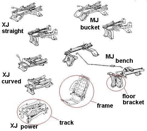

MJ is dead Posted April 27, 2010 Posted April 27, 2010 Went to a nearby junkyard today just svrounging and I stumbled on an mj. It has bucket seats and taillights But right next to it was an XJ limited with black leather interior....power everything, Will the seats bolt up to my brackets? And how bout the door panels?? I should be able to switch out the door handles from my non power mj doors right? Can I hardwire thes seats to work?? They're perfect! The mj seats he had weren't bad, but had one rip. He only wants 40 for the mj seats and 50 for the xj :help:
Boilermaker Posted April 27, 2010 Posted April 27, 2010 Nice finds. Since the XJ had a black interior, i'm assuming the XJ limited was an 89ish or earlier. Will the seats bolt up to my brackets i believe if your MJ currently has buckets (or if you grab just the tracks from the JY MJ) the XJ seats should bolt up directly to the MJ tracks. I'm not 100% sure on that, so hopefully someone else will come along to confirm or correct what i just typed. if you have a bench and don't want to buy the MJ tracks, its possible, just a little more work. Can I hardwire thes seats to work?? Hardwire as in using the 6-way power adjustments? the wiring itself would be just running power and ground from the fuse box to the power seat track...the problem is the power motors/mechanisms are part of the XJ seat track, and the XJ power seat track is not a direct bolt in on our MJs. And how bout the door panels?? if you aren't using any of the power accessories, you're going to have to cut a hole in the panels for your window crank. Other than that, i can't think any other major differences. I should be able to switch out the door handles from my non power mj doors right? there's no need to switch out your interior door handle either way, the handles are the same between the two. If you are going to use the power accessories, then you would need to grab the bezel out of the XJ limited for the switches.

dasbulliwagen Posted April 27, 2010 Posted April 27, 2010 The power seat adjustments are built to the frame, but if you unbolt the seats from the power frame, they MAY bolt up to the MJ tracks, you just wouldnt have power seats anymore. Not sure if the XJ seats had power backrest adjustment or not, but if it does you may have to rig power up to adjust your seatback... shouldnt be a big deal, but if I'm thinking correctly they didnt have that. I pulled power seats out of a 96 for my brother and it didnt have power backrest so you should be OK to just swap the seat pan and back.
88pioneer Posted April 27, 2010 Posted April 27, 2010 This should help with the seat conversion :cheers: viewtopic.php?f=9&t=8093
MJ is dead Posted April 28, 2010 Author Posted April 28, 2010 So my understanding is...I should buy the MJ buckets for their sliders and floor brackets, and the XJ seats cuz they're sexy? Then I can just take the cushion off the XJs and put them on the MJs?? Also, I need to get the "power" switch for my trans, can I snag that from this XJ too? The mj there is a 5spd
88pioneer Posted April 28, 2010 Posted April 28, 2010 Essentially yes, buy the MJ seats so you have the brackets, and the transfer over is pretty simple
