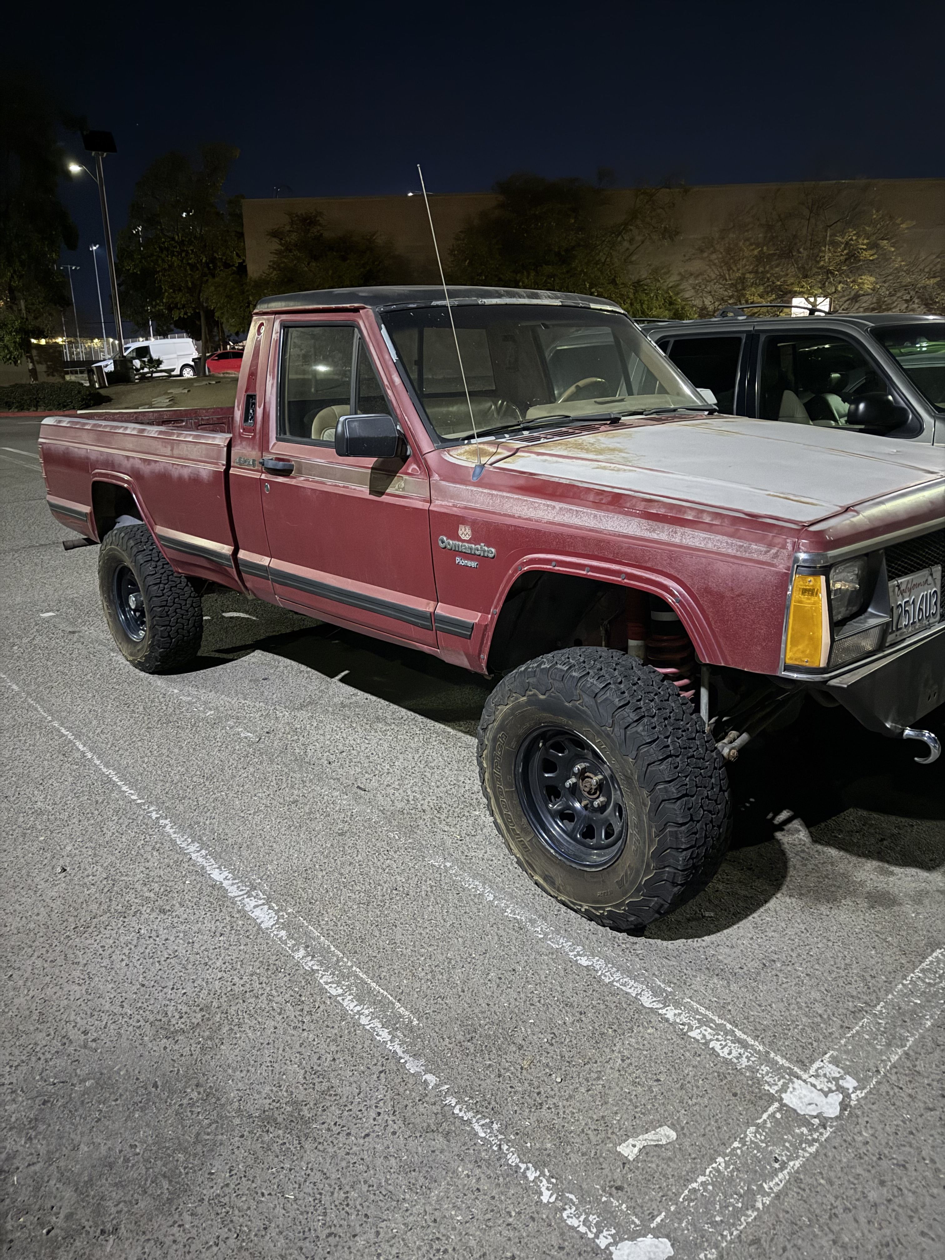

  1. Afternoon Yall, I've been toying with the idea of selling my 1988 Comanche. I decided to post here because I still don't have 10 legitimate posts, but if y'all want me to post it somewhere else let me know. Since I've been on Active Duty, I don't have the time to work on it and get it out as much as I would like to. I'd really like to get it into someone's hands who appreciates Comanches like y'all do. How much do you think is reasonable for me to ask for it and where should I go about listing it? Truck has working 4x4 4.0L 146000 miles Here is the list of everything I've done. New distributor cap Spark plugs and cables Converted from closed cooling to open Tj bucket seats New 746 injectors new battery and starter replaced clutch fan 180F thermostat Ball Joints and diff fluid EGR delete and new IAC Has SOA lift and sitting on 33in tires Cons Definitely needs new shocks Probably needs leaf springs Needs clutch Has BA-10 transmission Body is quite beat up
