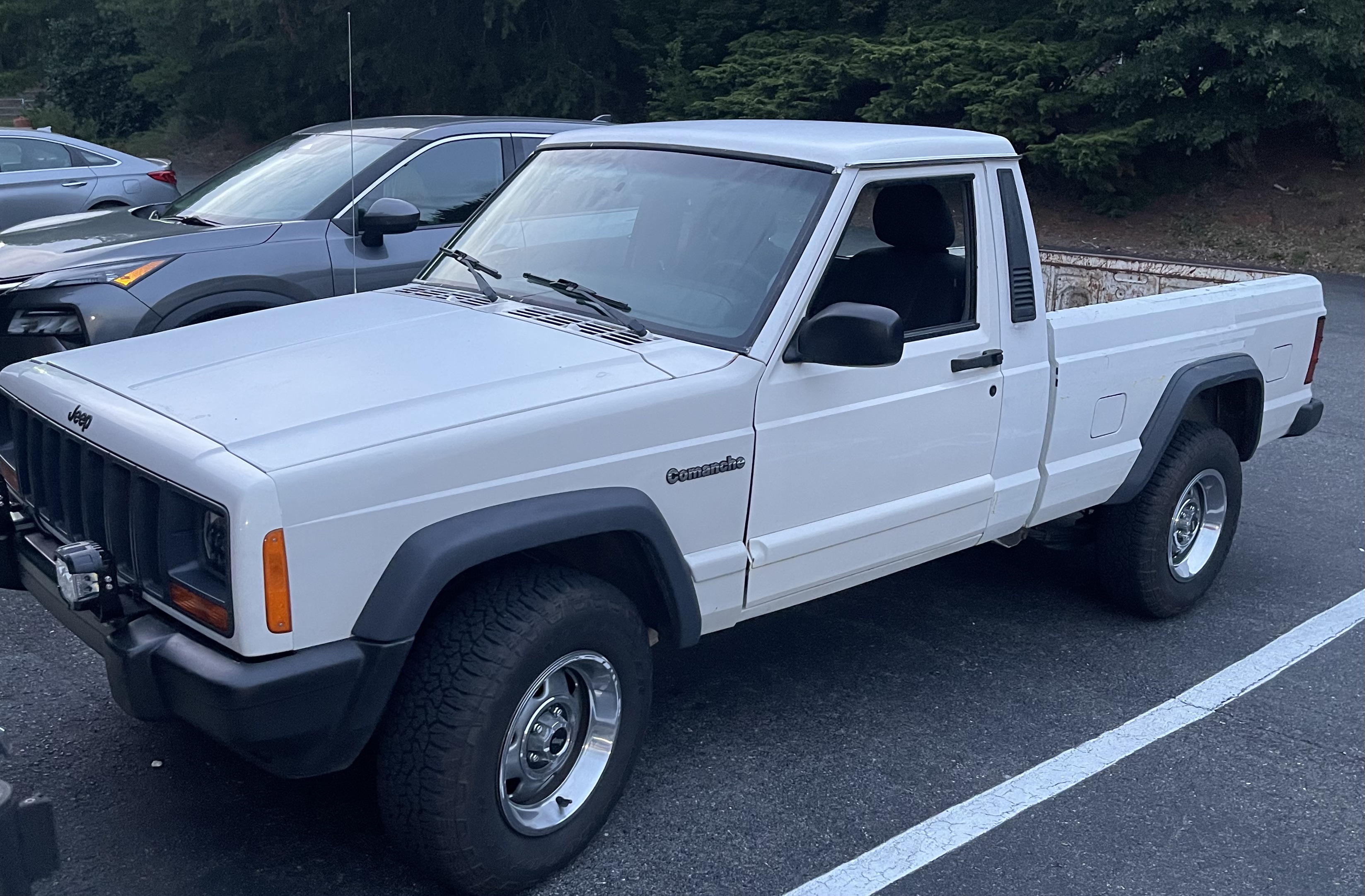

  1. I'm the proud and fortunate new owner of Project Scuzzy. What is the norm for sharing pics and progress for an MJ that already has a build thread? Makes sense to continue here with the detailed history that Jeff has already provided. Jeff was great to work with and I feel like I have a great daily driver that was painstakingly upgraded from a 2.5 2WD to what it is today. I've had "Scuzzy" here in Denver, NC for a couple weeks now. I've been removing the decals and glue residue from previous lower panel molding with a rubber wheel on a drill. I would normally use a heat gun and razor blade, but a local mechanic suggested a rubber wheel, ($12 on Amazon). I went to a local trailer shop and they wired the 4-flat and 7-way plug that is built into the Gladiator bumper. I splurged on a BW Tow & Stow hitch and installed the $150 tri-fold bed cover that fits a 2004-2012 Colorado w/6ft bed. Next project is to install a front lift to match the Metric Ton General Springs in the back that look like about 3" of lift. I picked up a set of MJ shackle relocation brackets that will add an additional 1 1/4" of lift. I also have some longer adjustable shackles I may use if needed to match the front. What shocks are people using for front and back with about 4" to 5" of lift? I'm planning to use Raptor Liner for the inside of bed. Should I use POR 15 first or another rust inhibitor before spraying the Raptor Liner? Body panels are pretty straight and I plan to keep the truck white, so I'm planning to tackle the dents and dings myself and find someone to spray a 15/15 paint job.
