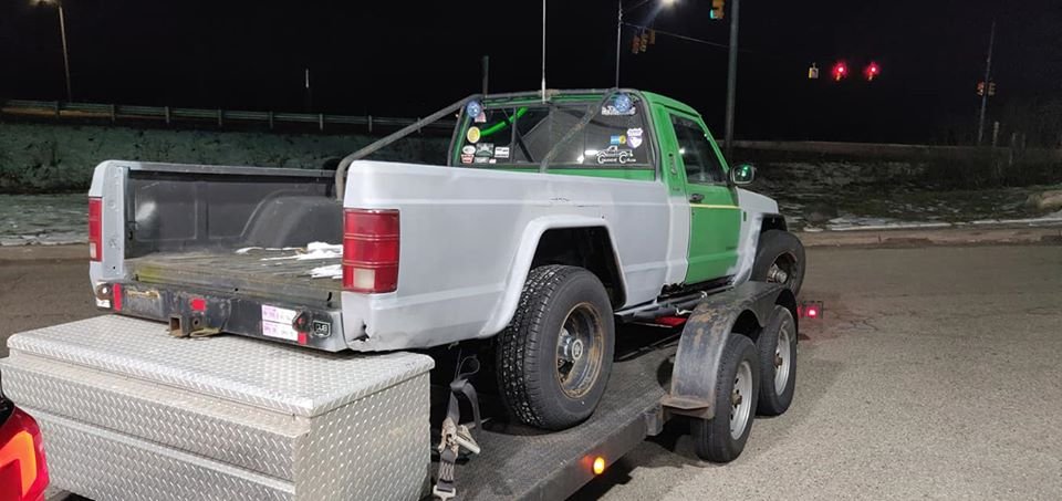

And so begins another vehicle build. I bought my 96' 2 door Xj when I was 15 (1st car), not knowing anything about Jeeps or off roading. Soon there after I learned what a Comanche was, and ever since I've dreamed of having one. Fast forward 13 years and the stars finally aligned. So why Cu in the Jungle? Well, I spent my teens and early 20's building my emerald green XJ and somehow copper spray paint became my accent color. I always wanted an Orange Mj, but a few years ago we did Orange Monstaliner on my wife's Tj and she informed me orange is now off limits (whoops). After learning the history of this particular Mj, I felt it was only right to keep it green (Jungle Love Monstaliner) with the additions of my copper (Cu) accents, because who doesn't love science jokes. Speaking of this Mj's history... A buddy of mine actually sent me the FB market place post, I had just gotten my tax return, and now it's mine. As with any FB sale, I did a bit of digging to verify the seller was a real person and found their build thread...which lead eventually lead me to the original owner's build thread. Some of you may remember this rig when BlueXJ built it 15 years or so ago. Sadly in it's current state it's barely recognizable compared to what it once was. The mind blowing part to me, and why this build is special to me is that I actually remember being a teenager and drooling over this build and thinking "one day I'll get there". It's easy to argue this exact truck is what fueled my dreams. Unfortunately this truck needs EVERYTHING. I basically bought it as a caged body with useless (to me) axles. The good news, and the other part of why this build means so much to me is that I have almost everything it needs. Sadly my XJ is doomed for the scrap heap. The rust got so bad that I needed to take action. I cut out a ton of metal and then learned my company was transferring us from southeast Pennsylvania to Michigan. The process took 2 years and by that point she was too far gone to save. Fortunately I convinced them to ship 1 more vehicle across the country on company dime hehe. I'll use my Xj as a donor for the interior, drivetrain, and as many extras as possible. I know I tend to be overly sentimental with my vehicles, but it means so much to me that I'll be able to carry over so much from my 1st vehicle into my dream truck. So here is a list of what I have that'll get swapped over: - 96' H.O 4.0 inline 6 with onboard air (AC compressor mod) - Aw4 trans - NP231 xfer case with full SYE - HP dana 30 with HD Yukon carrier and 4.11s - Police package Dana 35 with HD Yukon carrier, 4.11s, lunch box locker, BDS diff guard, and 30 spline chromoly shafts. I know it's a turdy five BUT, while working at a speed shop in college, a customer offered it to me as described with only 2000 miles on it all for $100. I couldn't say no on my budget. I plan on adding a truss to it. - IRO OTK cross over steering - JKS adjustable track bar - Dirtbound Offroad DIY winch bumper with hoop - Smittybilt X2O 8000ln winch w/ Quadratec Synthetic line -35x12.50R15 Dunlop Mud Rovers - My XJ dash, seats, and interior My final goals/plans are: - 35x12.50xR15s - 3-4.5" lift. The previous owner put new 4.5" rusty's leafs in it, and included new Rusty's 4.5" coils. I don't want to change the current tube fenders, so if I can clear 35's at 3" I'll be thrilled, if not I'll go to 4.5". I'm all about Squatty LCOG Jeeps. - CavFab 3 Alpha 3-Link - Tom Woods drive shafts - Jungle Love Monstaliner - Chassis saver under carriage - Some flavor of Monstaliner interior - Shocks (most likely Bilsteins) - Will eventually redo the steering and track bar setup Here are some more pictures of getting her home (200 miles round trip) The previous owner had only tack welded a new front suspension on. During loading, every tack broke and the axle came completely free. Luckily they had a skid steer to lift the front and walk in on the trailer. The ice covered and sloped driveway made it fun. The 10 degree Michigan weather and wind made it extra fun. The axle was trapped under the truck and I didn't have any equipment to lift it, so I had to drag it off the trailer with the TJ. Took nearly 4 hours of inching because I couldn't get the wheels straight. So it was move forward 2 inches, then re position the TJ, yank it sideways, repeat about 50 times. The best part is that my winch solenoid quit half way off the trailer. Luckily my friend who sent me the posting and helped me retrieve it was in town and brought his Jeep/winch over to finish the job. On jack stands and roughly where she will sit. Rear bumper is solid and staying. Fortunately it came with something I like because my XJ rear bumper rotted out beyond use or repair. The cage was a huge factor in buying this truck. I knew i was going to need one, but I don't have a tube bender or the welding skills to SAFELY do it myself. Well, that's all I have for now. I probably won't be doing much work or posting in the next few months. I'm going to use the last bit of winter to stay warm, pinch my pennies, stock pile parts, and formulate a plan for spring.
