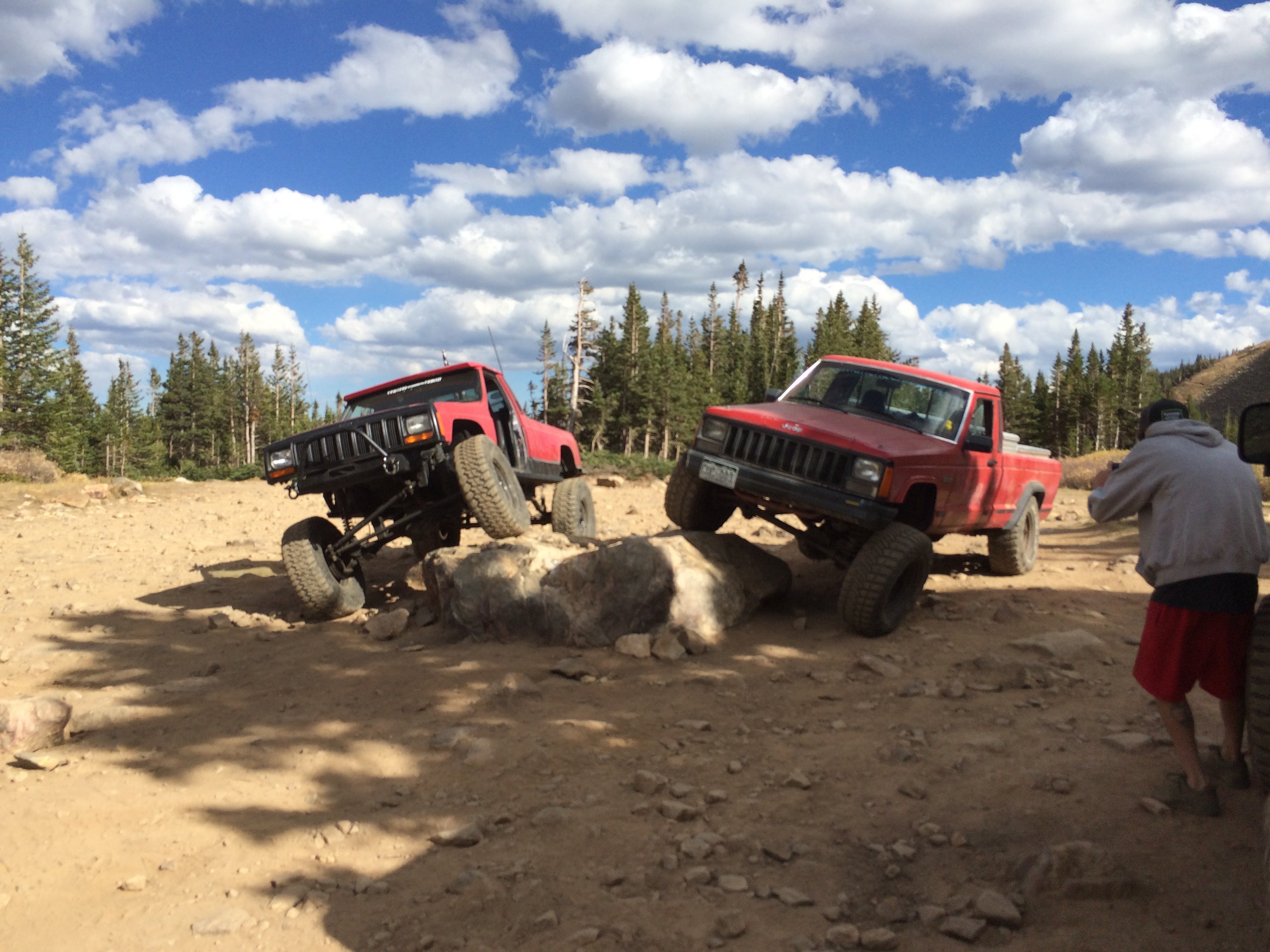

Hey, new owner of the truck here. I figured fans of the truck might be curious as to what it has been doing for the last year... The J.O.E has taken a few trails. Rolled over Redcone Pass with no sweat. Ripped up bill more lake, twice once with snow once dry. Did Red elephant - Nearly over heated - See my friends video of bouncing it on up ( https://photos.google.com/share/AF1QipPINq8-8JvnF4rwcCCRAMyZJM-IvAJ053VgRWU7KoYSiKu6n9CcTYbFOoH4QVhz2w?key=V2FfX3Q3NU9hcXMxbVh2UmpHdHhoYXRuOTdVb3Nn )- 170 replies
