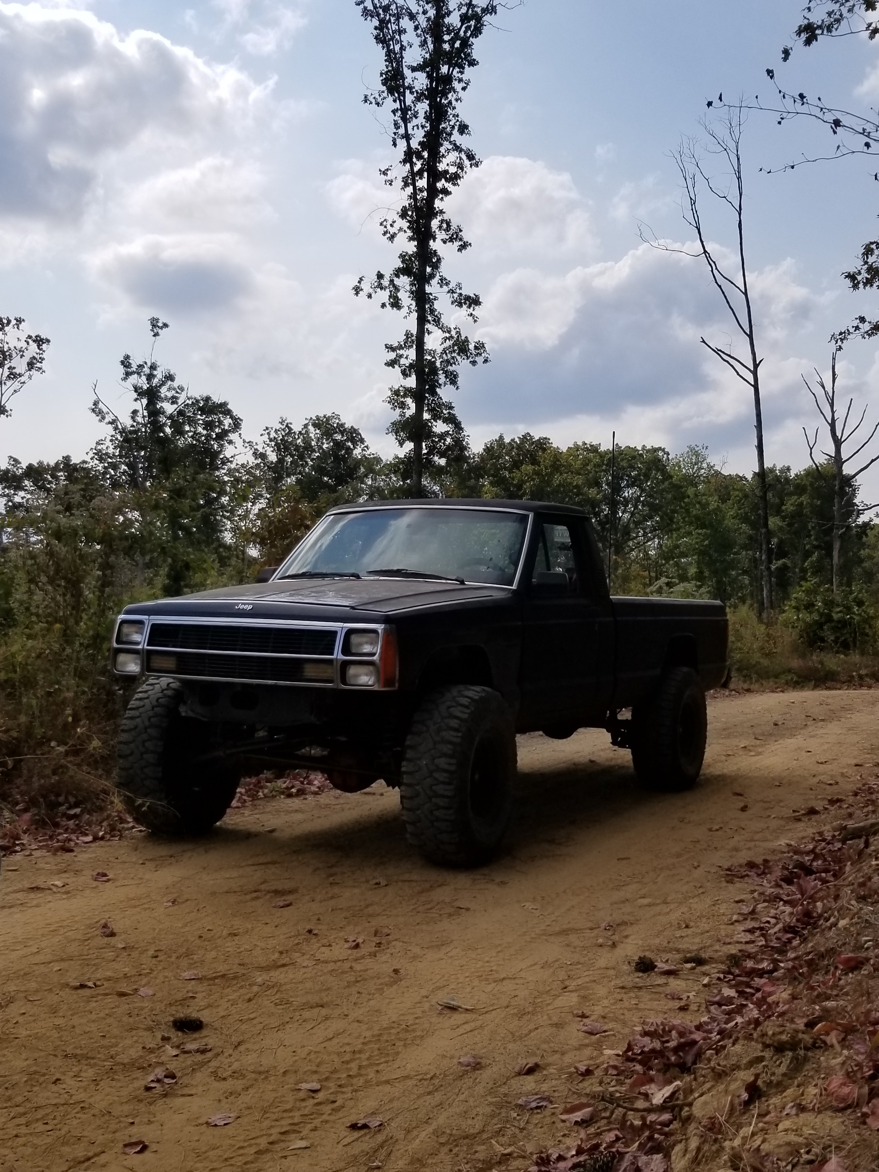

  3. Thank you for giving it a read! I unfortunately don't have a picture of the air cleaner i went with but it was 30$ on ebay and clears the hood great! , ive looked into the fast efi systems for my 2nd gen camaro and have considered it as well , i havent ran into any issues with the carb loosing fuel or loading up on the trails ... yet! 😂
