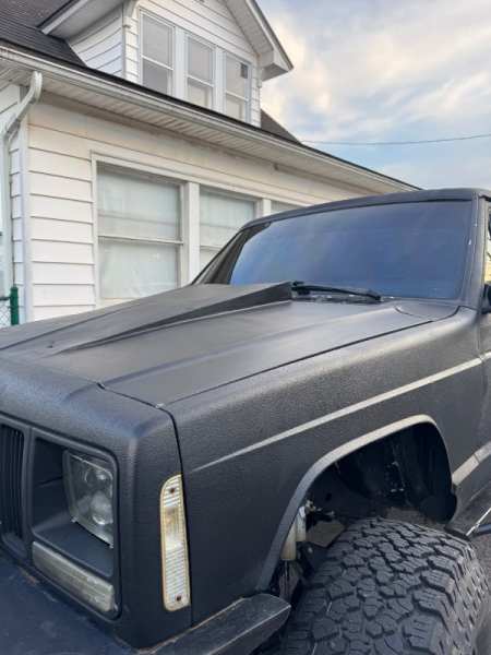

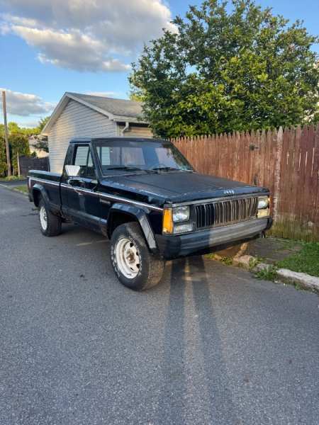

Finally purchased my dream truck '88 Jeep Comanche. It's rough around the edges (literally, the whole truck is Rhinolined) but with some hard work and patience it will be looking great! I will document my progress here, and put a build list below, along with my plans for it. Excited to be part of the community, especially after owning XJs my entire life. Pictures from the day I bought it below.

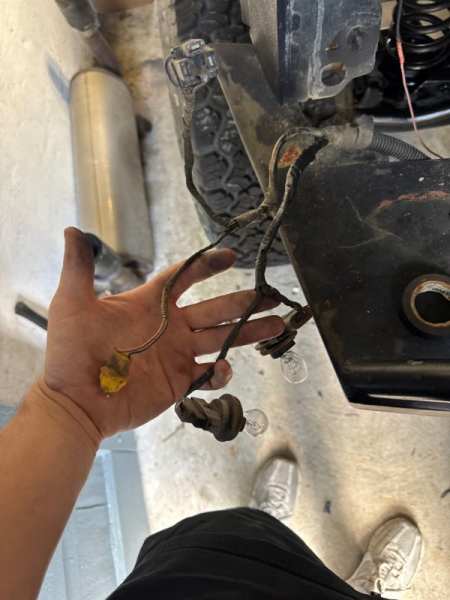

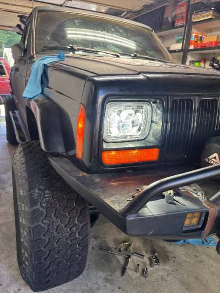

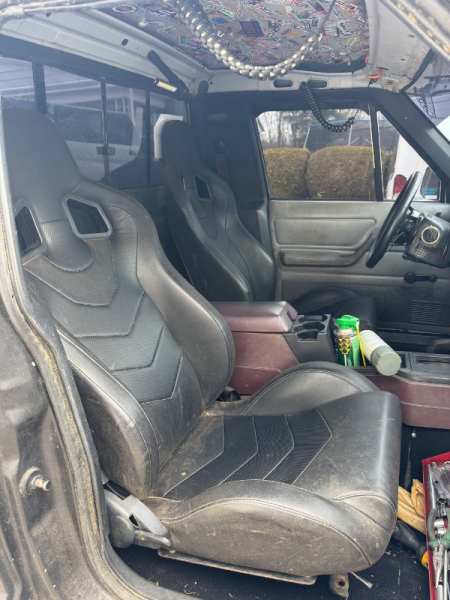

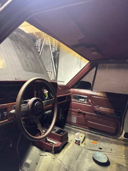

Updates so far. Full service, along with new oil pan, oil pan gasket, and rear main seal. I also sanded down and painted the axles and some of the suspension components. Went ahead and redid the 97-01 front end so I can have flares and also spliced in the wiring for the marker lights. Purchased Comanche #2 to poach the interior, and it is cleaning up extremely nice! Headliner reupholstered with a wine colored suede, matches close enough for $12! Floor pans next...
  • 2 months later...

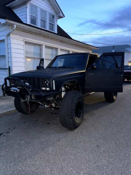

Quick update - Comanche took a back seat while the Cherokee got some love. I installed a 6.5 inch long arm kit, crossover steering, and an SYE kit. Along with some new shoes of course, KMC KM549. Also picked up some nice seats and some other parts, cleaned up and ready for the Comanche.
