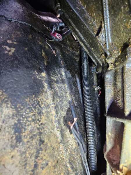

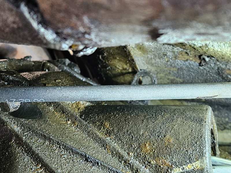

TheMaddTitan13 Posted March 7 Share Posted March 7 I'm stuck guys. I got my clutch changed, and bolted back up. My truck turns but won't start. Ive got 3 pairs of loose end wires. & for the life of me can't figure out where they go or why it won't start. I could only get bad pics but hope they help. The connectors crumbled away so they are just lose ends. Any help would be awesome. One wire seems to be clipped to the driver side top of tranny and the other I'm assuming is the speed sensor on the passenger side? Link to comment Share on other sites More sharing options...
87MJTIM Posted March 7 Share Posted March 7 Sounds like your CPS wires. Look in the engine bay at back of the valve cover for a connector Link to comment Share on other sites More sharing options...
TheMaddTitan13 Posted March 8 Author Share Posted March 8 7 hours ago, 87MJTIM said: Sounds like your CPS wires. Look in the engine bay at back of the valve cover for a connector That was it! I didnt notice it when I dropped it, I pulled it out of the connector up top! Link to comment Share on other sites More sharing options...
