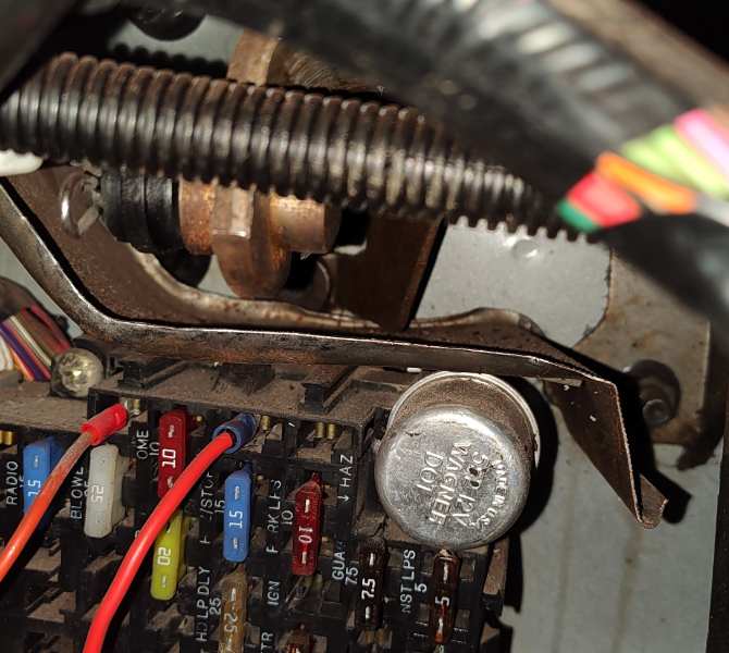

Eagle_SX4 Posted January 19 Share Posted January 19 2 hours ago, NickyV said: What have people done in regards to improving their fuse box? Right now, I'm thinking that maybe I can clean it up and then figure out some way to put a cover over it. I wonder if I can find a plastic box with a hinge that I could modify and then place the fuse box inside of. That way if the master cylinder leaks in the future at least it won't drip directly onto the fuse box. I made a drip tray for my master cylinder that sits on top of my fuse block. It is held in place with some double sided mounting tape. I will get a pic tonight of what it looks like. Link to comment Share on other sites More sharing options...
Eagle_SX4 Posted January 20 Share Posted January 20 This is what I made to keep any brake fluid off the fuse block. Link to comment Share on other sites More sharing options...
NickyV Posted February 13 Author Share Posted February 13 That's simple and smart, @Eagle_SX4 Thanks for sharing! Link to comment Share on other sites More sharing options...
