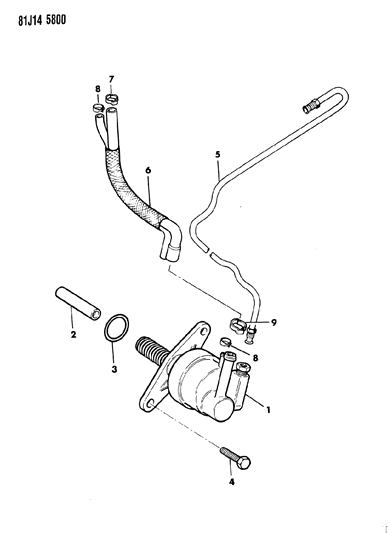

Dylanh86 Posted December 5, 2025 Share Posted December 5, 2025 on my 1986 2.8 Comanche the fuel line is stuck going from the mechanical fuel pump to the carb. Does anyone know how to get it off or have the fuel line because I can't find it anywhere. Link to comment Share on other sites More sharing options...
Gojira94 Posted December 6, 2025 Share Posted December 6, 2025 Welcome to the forum. Hopefully someone with a 86/ 2.8 MJ can offer some feedback as well. If you're referring to #5 in the diagram you might try the usual PB Blaster on the fitting and some gentle taps with a brass hammer first. If you don't have flare nut wrenches you can pick those up for about $15 apiece at your local parts store. You can determine the size with standard combo wrenches first. Or are you battling #6? On those you'll need to pry open the metal collars #8 / #9 that secure them to the pump before you can slide them off. Link to comment Share on other sites More sharing options...
