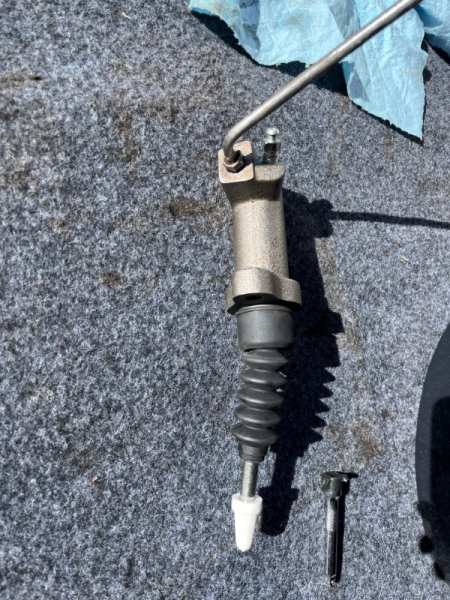

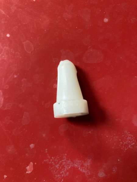

eaglescout526 Posted November 2 Share Posted November 2 This cone. It goes on the end of the rod/boot If you don’t have this the clutch will barely engage enough to shift. If it’s still getting air into it, it could be the seals are shot and need a rebuild at both the master and slave. Or there’s a pinhole leak in the lines. Link to comment Share on other sites More sharing options...
aris_garage_builds Posted November 2 Author Share Posted November 2 11 hours ago, eaglescout526 said: This cone. It goes on the end of the rod/boot If you don’t have this the clutch will barely engage enough to shift. If it’s still getting air into it, it could be the seals are shot and need a rebuild at both the master and slave. Or there’s a pinhole leak in the lines. Ah I see, I bet that is exactly what is causing this problem! It looks like it this part: https://www.summitracing.com/parts/cwa-j3217479 I'll probably pull the system out and bench bleed it just to be safe (and ensure air isn't getting in somewhere) but given that the clutch won't fully disengage I think this is exactly what's needed. Thank you so much, I had no idea this little piece even existed! Link to comment Share on other sites More sharing options...
eaglescout526 Posted November 2 Share Posted November 2 That looks like it’s it and no problem! I learned the hard way once what it’s like to shift without that cone and it gave a really interesting half disengagement and a audible clunk while forcing the clutch pedal to stop half way through travel. But that cone should give you the extra amount of travel you need to get back up and running. After a while they just disintegrate. Link to comment Share on other sites More sharing options...
