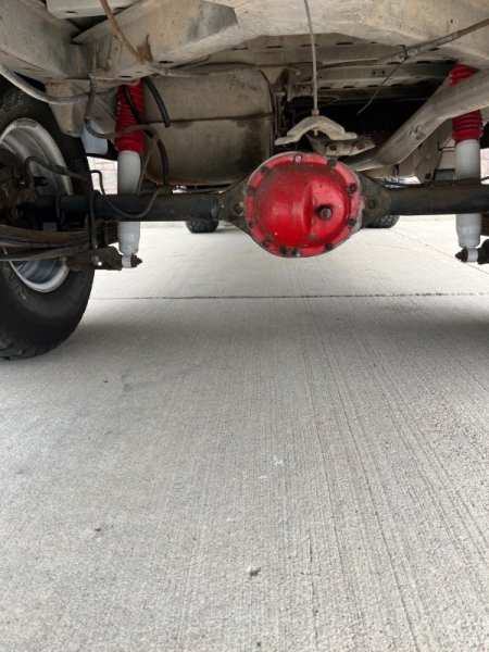

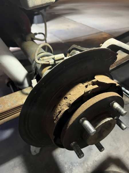

PomPom Posted October 17, 2025 Share Posted October 17, 2025 Good morning all, was hoping someone maybe able to shed some light on a rear axle in my Comanche. The diff cover says D35 but the disc brakes with internal drums are throwing me for a loop. The rear inner drums are shot and I’ll need to purchase replacement parts before attempting to connect the e brake cables. Someone thought it was a ZJ swap but I figure someone may have done this and maybe able to help point me in the right direction for not only parts, but for using brake cables. Thank you all and God Bless! Link to comment Share on other sites More sharing options...
Pete M Posted October 17, 2025 Share Posted October 17, 2025 I do believe the Explorer brakes are another swap option and I know they come with internal drums Link to comment Share on other sites More sharing options...
