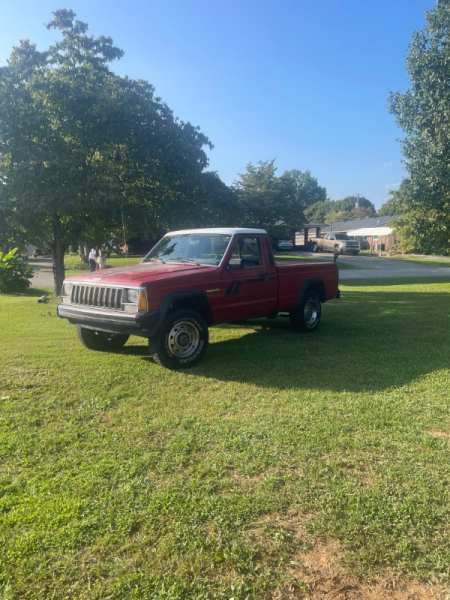

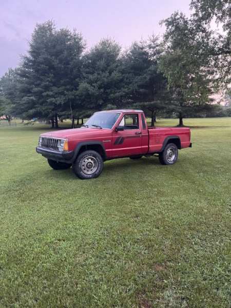

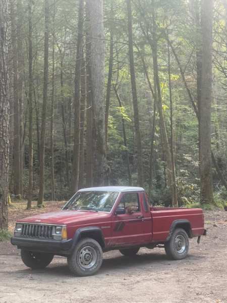

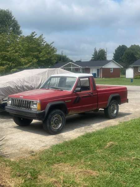

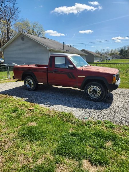

AWayne Posted August 25, 2025 Share Posted August 25, 2025 First image is when I got this thing for $800 almost two years ago. 2.5 / AX4 / A/C / 3.55 gears. Previous owner took the alternator and all the brackets off, and give up halfway through reassembly. Link to comment Share on other sites More sharing options...

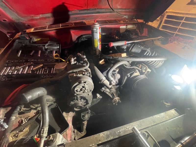

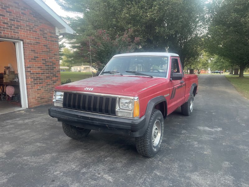

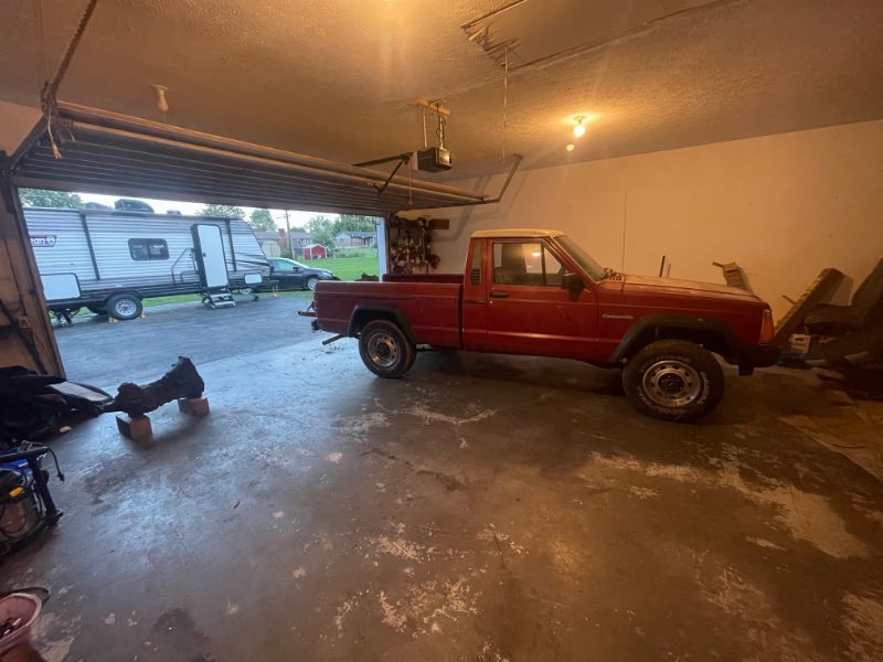

AWayne Posted August 25, 2025 Author Share Posted August 25, 2025 Next up is after reassembling everything. Alternator was fine. Engine was loud. Link to comment Share on other sites More sharing options...

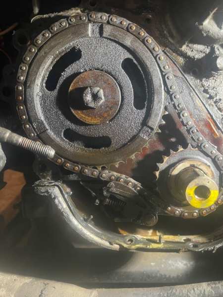

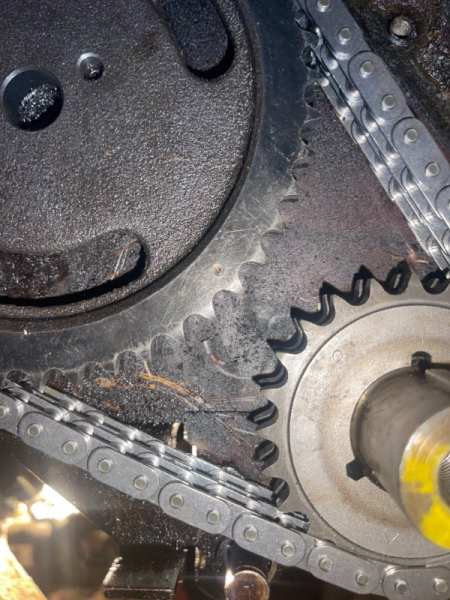

AWayne Posted August 25, 2025 Author Share Posted August 25, 2025 To fix the noisy engine, tore apart the front and found a very nasty timing cover and timing chain well past its expiration. Used a 4.0 double roller as a replacement. 9-3127 Cloyes. Runs quiet now. Link to comment Share on other sites More sharing options...

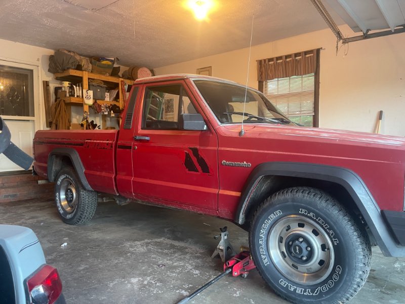

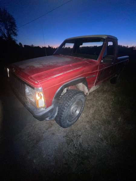

AWayne Posted August 25, 2025 Author Share Posted August 25, 2025 Decided to level the front so used XJ "Upcountry" package 1" lift springs. Worked perfect. KYB Gas-A-Just all the way around as well. Link to comment Share on other sites More sharing options...

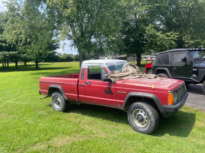

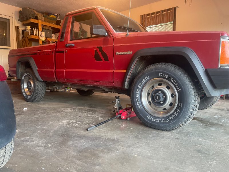

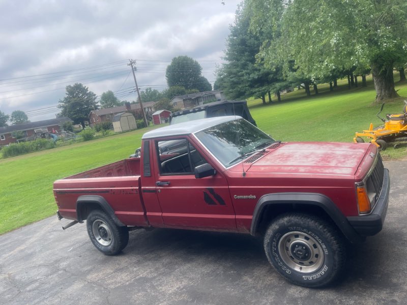

AWayne Posted August 25, 2025 Author Share Posted August 25, 2025 Next, rattle canned the roof white and the grille black. Swapped the headlight bezels for chrome and went with conversion headlights that use H1 bulbs. Link to comment Share on other sites More sharing options...

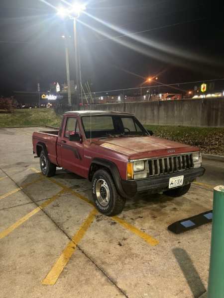

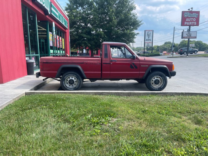

AWayne Posted August 25, 2025 Author Share Posted August 25, 2025 A deer decided ram the fender last year. Then the water pump went out. Then the (internal) slave cylinder. Link to comment Share on other sites More sharing options...

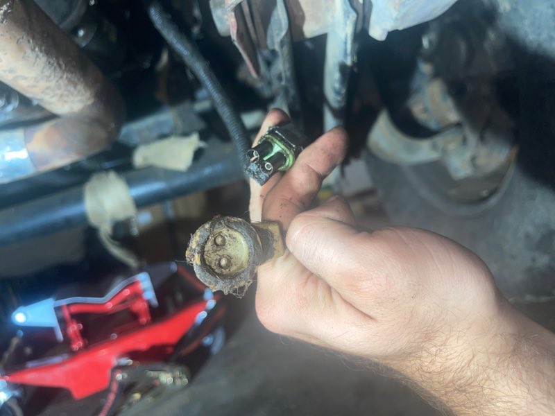

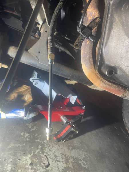

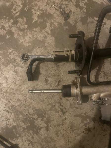

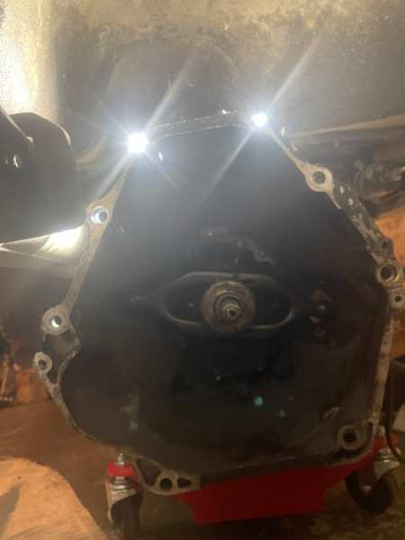

AWayne Posted August 25, 2025 Author Share Posted August 25, 2025 Now swapping in an (external slave) RWD AX5 from a 2000 XJ. Also installing a Core Shifters short throw. Had to splice the clutch lines together. Used the factory clutch hose. Found an adapter from 7/16-24 to 1/2-20. Then 5/8 steel line to compression fitting to the external slave nylon hose. had to swap to the cable driven speedo housing from my AX4. using factory 1988 Clutch master cylinder Everything else looks the same. Not finished yet. Maybe finish it up tonight. Link to comment Share on other sites More sharing options...
fiatslug87 Posted August 26, 2025 Share Posted August 26, 2025 19 hours ago, AWayne said: Now it matches the shed. Welcome and add it to the Registry when you get a chance, someone will get you the build sheet. Link to comment Share on other sites More sharing options...
AWayne Posted August 26, 2025 Author Share Posted August 26, 2025 Matching the shed to the truck is the ultimate neighborhood flex 😎 I'd forgot about the registry! I'll get right on it. Link to comment Share on other sites More sharing options...
