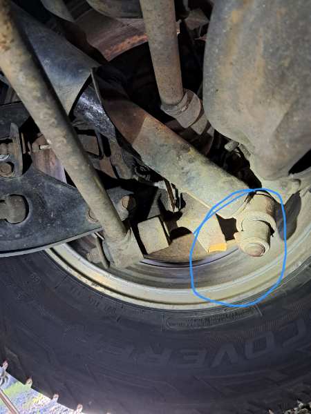

NC Tom Posted August 15, 2025 Share Posted August 15, 2025 Recently I was run off the road by some douche rocket driving in my lane coming around a blind curve. This happens a lot in Watauga Co.! I hit a DEEP pot hole and busted a lower shock mount on my 2004 Honda Pilot. I've been under it, but I can't tell exactly what's broken. I'm thinking it's the knuckle. Anyone have any other ideas? Link to comment Share on other sites More sharing options...
Eagle_SX4 Posted August 15, 2025 Share Posted August 15, 2025 After a quick Google search it seems like a common issue on those Pilots. Looks like you will need a new rear knuckle to fix it as the shock mount was cast into the knuckle. Here is a forum post about it. https://www.piloteers.org/threads/lower-rear-shock-mount.171108/ Link to comment Share on other sites More sharing options...
