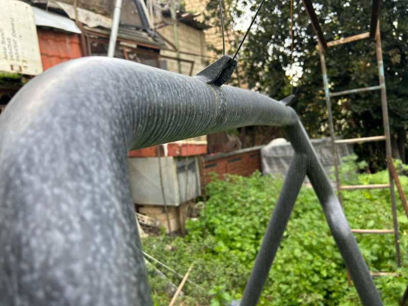

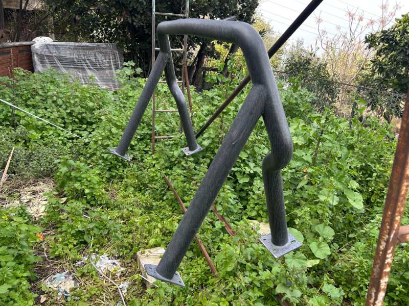

ghetdjc320 Posted July 16, 2025 Share Posted July 16, 2025 This is the best idea imo. But 20 gauge is particularly thin. Mandrel bent exhaust tubing that is 16 or 14 gauge is the way to go here imho. I’ve also looked into doing this. Thbest I could figure is to just sell the 5 bend pieces and the mounting plates. Then let the end user get the straight 3” tubing locally and weld it up. Heck, you could pack that up into a fairly compact box. Link to comment Share on other sites More sharing options...
