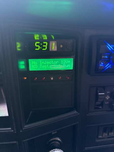

ja_racing Posted June 16, 2025 Share Posted June 16, 2025 Anyone familiar with what exactly the rem codes mean new to me just installed one and have 2 codes pop up periodically in the morning only Link to comment Share on other sites More sharing options...
Eagle_SX4 Posted June 16, 2025 Share Posted June 16, 2025 Here is a list of codes for the REM. If you scroll down to ECU codes section you should find what you are looking for. https://nickintimedesign.com/rem-codes-description/ No Injector 12V ECU did not detect 12V on Injector feed wire. -TIP: If this code shows with “KO Tests Not Run,” it can be ignored. Link to comment Share on other sites More sharing options...
ja_racing Posted June 16, 2025 Author Share Posted June 16, 2025 Thanks! I just found the description Link to comment Share on other sites More sharing options...
