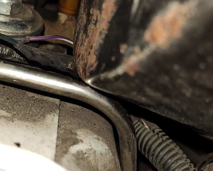

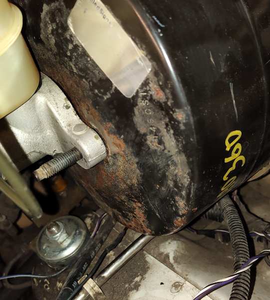

Eagle_SX4 Posted June 11, 2025 Share Posted June 11, 2025 Any one done the upgrade on an '87 4.0. I test fit the booster (pulled from a '98 XJ) today and it rests on the fuel line. Do I need to move my fuel line? Link to comment Share on other sites More sharing options...
AZJeff Posted June 11, 2025 Share Posted June 11, 2025 The photo appears to show clearance for the fuel linebetween both the booster and the inner fender/chassis. If that is the case, there is no need to move the fuel line. if you are really concerned about rubbing/vibration between the fuel line and the surrounding stuff, clip a pice of rubber hose over the fuel line to act as an insulator. Link to comment Share on other sites More sharing options...
Eagle_SX4 Posted June 12, 2025 Author Share Posted June 12, 2025 I was able to move the fuel line 2.5 inches out board and that fixed the clearance issue. I drilled a new hole for the existing clip. Link to comment Share on other sites More sharing options...
