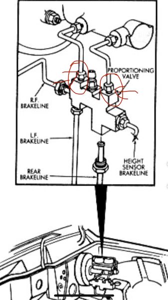

InTacosWeTrust Posted May 2, 2025 Share Posted May 2, 2025 Hello, I am changing my MC and My BB to a bigger version due to my lift size and tires. i am looking for the fitting sizes for the distribution or proportioning valve (whatever it’s called) only the top 2 fittings where the MC connects to the DV. The sizes on my MC are m10x1.0 and m12x1.0 The fitting sizes that I need are attached in the photo. also I tried to make my own and I failed miserably, If anyone has any information on where to buy pre made braided or hard brake lines, that would be much appreciated. thanks! Link to comment Share on other sites More sharing options...
ghetdjc320 Posted May 2, 2025 Share Posted May 2, 2025 All the prop valve fitting are 3/8-24 inverted flare iirc (or possibly one of them is 7/16). What you can do is get some short premade nicopp lines with the correct fitting for the prop valve then use adapters for the master cylinder side. The metric bubble flare adapters can be purchased at most auto parts stores. They will have the m10 or m12 bubble flare on one end and a 3/8-24 inverted flare on the other. Link to comment Share on other sites More sharing options...
InTacosWeTrust Posted May 3, 2025 Author Share Posted May 3, 2025 The front top one is 7/26-24. the back top one closest to the cab is the one I’m not sure about, I know that it is a 1/2 to take it off, so is that fitting size 1/2-20 Link to comment Share on other sites More sharing options...
