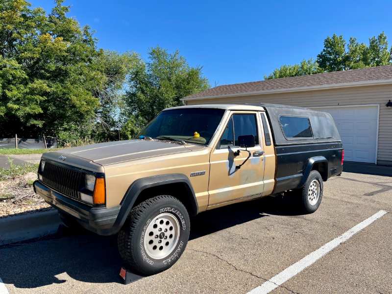

To cover some stuff I missed over the break, I was able to find a few key items for the Comanche. First, after lots of hunting, I was finally able to track down a long bed topper on facebook marketplace. I appears to be a Leer topper and fits perfectly. It needs a repaint, and one of the windows repaired, but otherwise is watertight and in pretty great shape!
I also ordered a hitch from Krusty here on the CC vendors section. It fits like a glove and will be great to have for small towing jobs once the truck is running again! The truck came with Wey bumper which is not compatible with the hitch (they share the same mounting holes and don't fit together) however this bumper is super dented and rusted beyond saving. So I was planning on removing it anyway. I plan on getting a JCR DIY Bumper to replace it, which I might have to fab up a custom mounting solution for to fit with hitch - I'll cross that bridge when I get there haha.

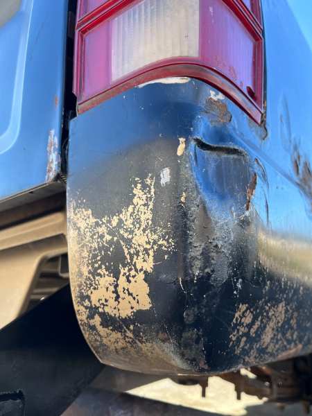

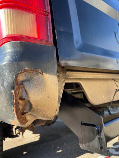

The bumper was dented / missshaped enough that it made significant contact with both the bed and the tailgate. You can see where it would grind when lowering the tailgate based on where the paint has been scuffed up. I've also got some pretty massive dents on the bed corners from the bumper hitting it. However there's rust in that area that needs removed anyways, so I've ordered new bed corners from Key Parts to replace entirely with clean metal. Lots of bodywork in my future :roflmao:

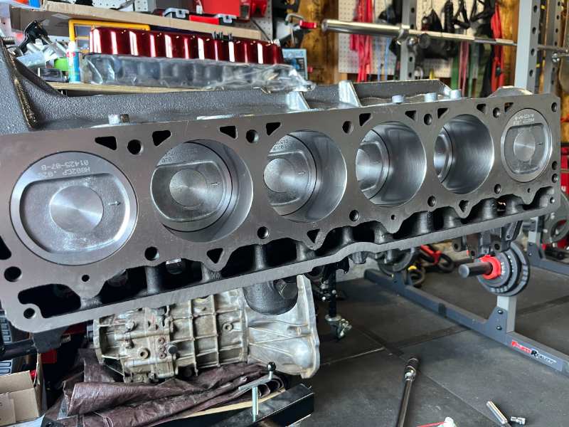

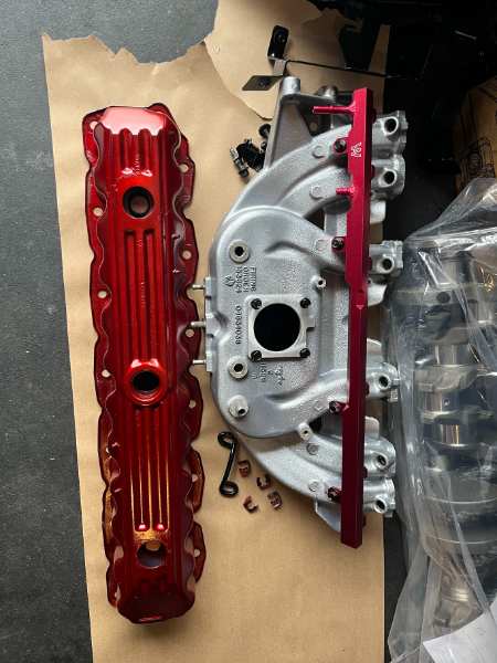

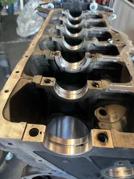

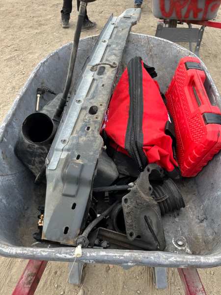

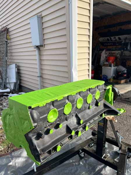

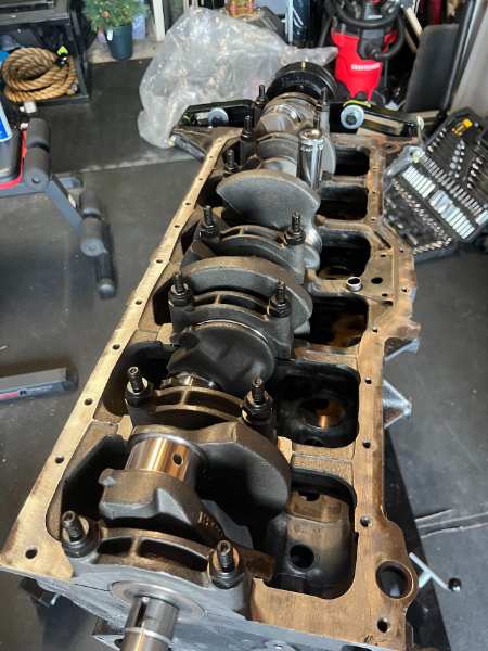

Lots of progress on the 4.0 rebuild. Made a trip to the junkyard to grab some XJ odds and ends that I was missing, and then got everything cleaned up and hit with a coat of paint.
IMG_8251.jpg.ba53e729fbbca2e01a91ac9b364b5728.jpg IMG_8102.jpg.52d3ae3495d6edcf9cabfce8c84b7de0.jpg IMG_8480.jpg.05e3486377003131e7b907b45d16a2f2.jpg IMG_8465.jpg.7a4dc774cfa06ab430a5197619bf07ae.jpg

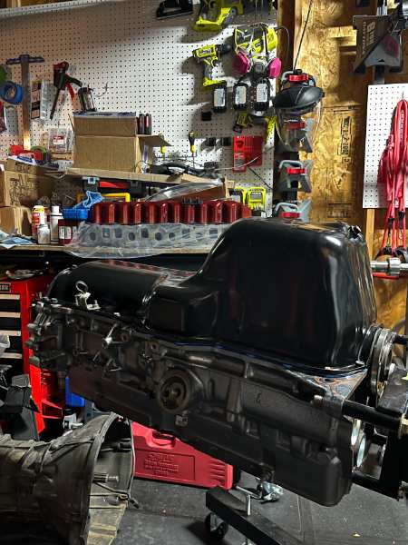

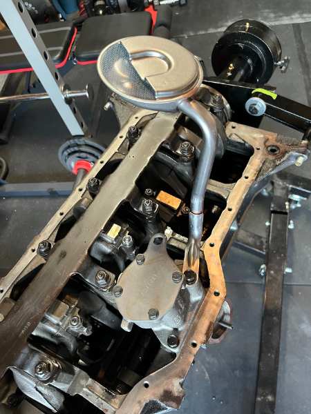

Once everything was ready to go, I began assembling. The bottom end came together fairly quickly. The only thing that gave my issues was getting the oil pump pressed into the pickup tube. I tried all the usual tricks but still couldn't get it in. I ended up grabbing a special tool / driver and it immediately pressed in. Best $20 I've spent so far :roflmao:Proform 66491 Oil Pump Pick-Up Driver Tool
IMG_8512.jpg.827a8632944548da64966e19a1ee93f2.jpg IMG_8513.jpg.dbd270adb835f514a26c81eff6f9a982.jpg

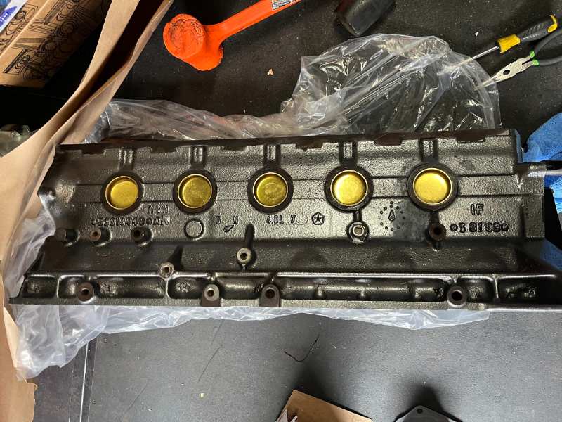

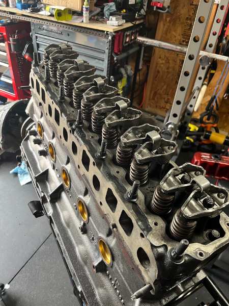

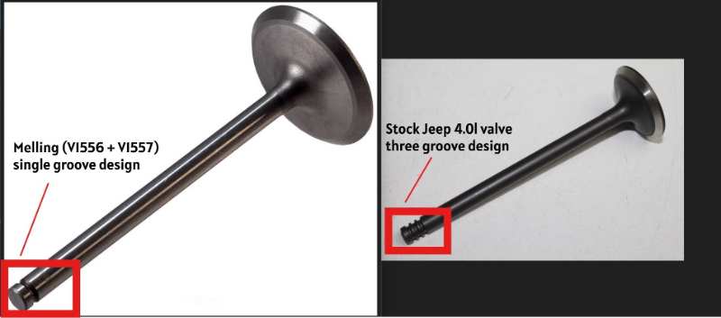

The top end however, I ran into a bit of an issue when installing the valve train. This block is from a '99 XJ and I didn't realize that was a transition year where the valves + retainers switched from a single groove to a triple grove. The new Melling Valves I ordered have the older single groove design while my existing retainers were the triple groove. Luckily a new set of retainers were fairly cheap, albeit backordered so they took a few weeks to arrive. Crown Automotive Valve Spring Retainer Keepers 33003521. Once they finally arrived, they fit like a glove.

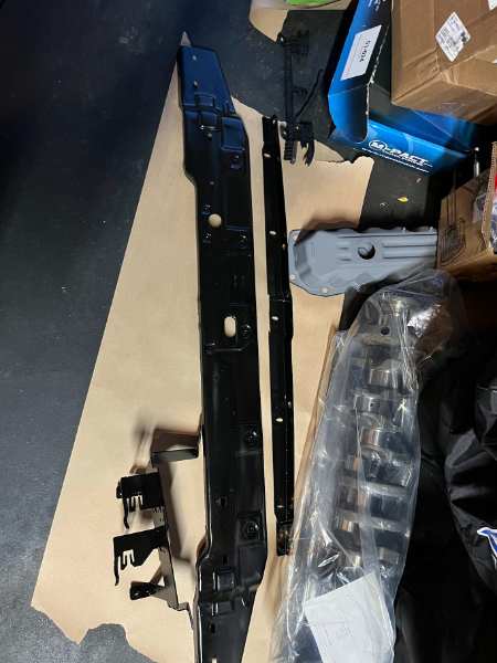

More progress on the rebuild. With the new valve retainers I was able to get the rest of the valve train buttoned up. Now onto accessory drive. Weather has been a bit bad for body work, but I got my key part replacement bed corners in. It should clear up soon and I'll start stripping what's on the truck to prep for welding. I'll also need to do a little fabwork in the engine bay before I begin swapping things over. I've got the pesky 86 firewall which won't quite clear the 4.0l - I know most folks just push it back a few inches with a BFH, but I wanna try to weld in a piece of an XJ panel. Planning on doing the same for the radiator support and hood support.

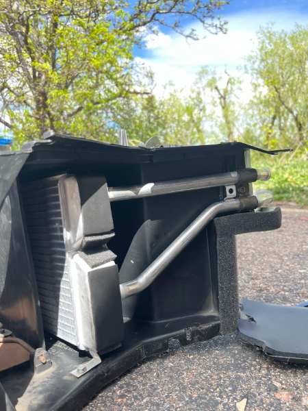

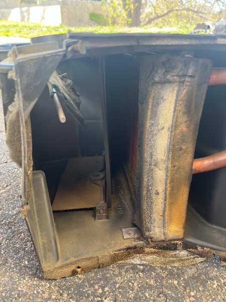

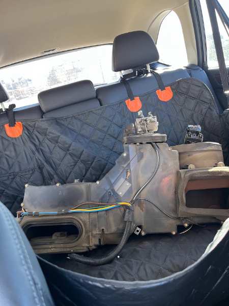

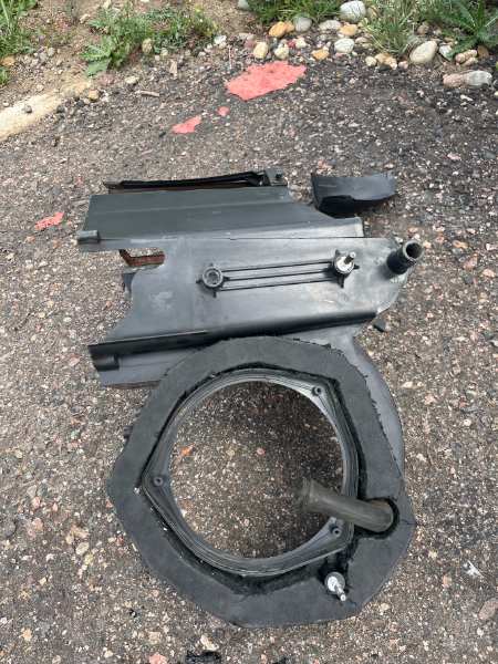

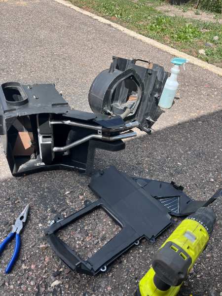

I also managed to snag a HVAC box from a '95 XJ - My MJ did not come factory equipped with AC and I figured when I already have the dash pulled apart for the swap there's no better time to add it. The old box was pretty disgusting inside... so I scaped off all of the crusty foam, power washed and scrubbed it out with dish soap, and re-foamed it inside. This took significantly longer than I'd care to admit, but I think it will be well worth it for cold AC in the summer. Plus there's no chance I get my fiancée to ride along in the jeep without it :roflmao: The entire box is covered in a mix of 1in and 1/8th thick foam (I tried 1/4 at first and it was just a bit too thick to clear in certain areas. Getting some with an adhesive backing made it way easier to mount, all I had to do was trace over the old foam shapes and cut it out. New Heater Core, AC Evaporator Core, Blower Motor, and Resistor are going in the box as well.

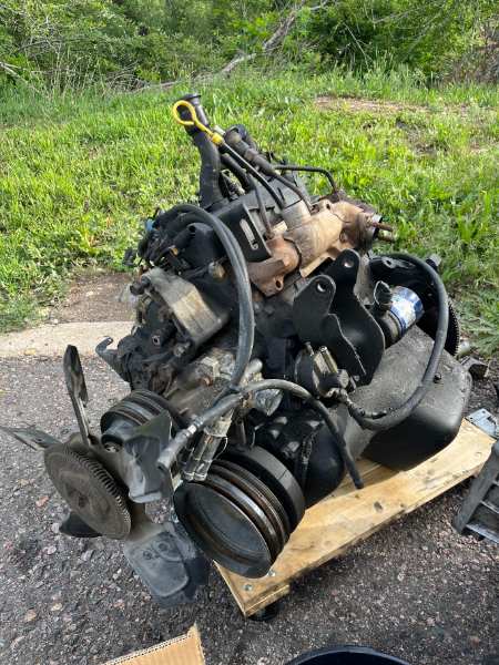

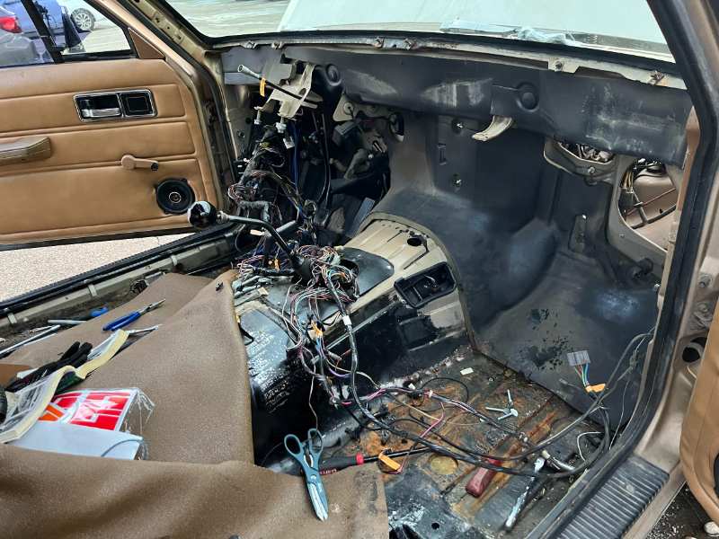

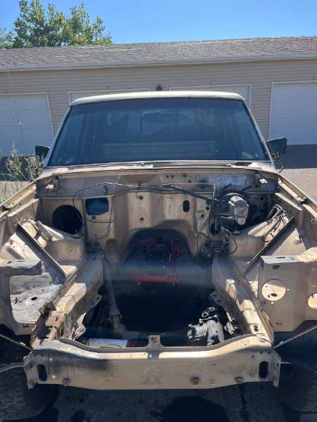

I've been chipping away at prep work for the 4.0l swap. Got the interior and engine bay entirely stripped.
Out with the 2.8l

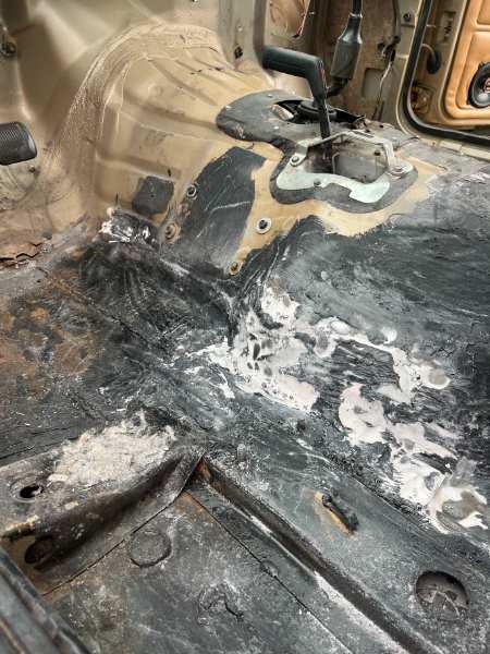

When pulling out the interior I was expecting the worst with the floor pans. the passenger side had a very small amount of surface rust, but nothing crazy. The driver's side however was pretty interesting.... Someone has clearly replace the driver floor pan before. However only the front section is welded.... the entire back half is just attached with bondo :eek: The welds at the front are not good to put it nicely haha, and it looks like the previous owner got frustrated half way through and rage quit on welding the thin sheet metal. So I'm adding that to my list of things to address while I have the interior out. There's multiple pounds of bondo here, I've spent a few hours sanding and still haven't gotten through it all. Once this floor pan is fixed I plan to Mastercoat the floors and add sound deadening before I reinstall the interior.

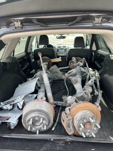

I'll end on a more fun note - I saw a deal that was a little too good to pass up on and made an impulse purchase. The CAD D30 and D35 are going to get replaced with an upgrade :applause:
