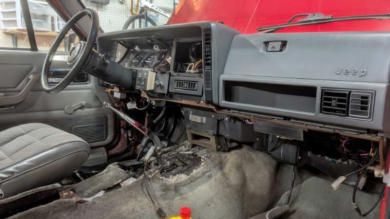

Salvagedcircuit Posted July 5, 2024 Share Posted July 5, 2024 14 minutes ago, Torq_Shep said: Found the issue with the brake lights. The Ignition Off Drain (I.O.D) connector was just completely missing on the battery side. I have no idea when this happened or how I had taillights from San Antonio to Salt Lake before they just stopped working completely but whatever... I made a new taillight harness with 18ga GXL wire, pigtails from ACDelco LS253 sockets and Standard S768 sockets. I tinned all of the wires and connected them with brass open face crimps covered with double wall adhesive lined heatshrink. The entire harness is wrapped in Flexon 3/8" solid sheath and I terminated the 6 pin with a deutsch as the 1991-1992 is not a plug I can find new currently. Overkill but I never want to do this harness again on this truck =P The parking brake was also not working. I had tried just adjusting the cable and that did not work. This truck has a D44 with disc brake conversion on it so I had a feeling that the parking brake pawls were out of adjustment. Popped the back wheels off and manually adjusted the pawls and now the parking brake works fine. I will eventually convert it back to a foot brake. Last thing I did yesterday was to wash the truck. The paint is way worse than when I parked it 2 years ago but I knew it was going when I bought it. Still looks okay from 10 feet away. Just ordered plates for it so I will likely get it registered in the coming weeks. Washington is surprisingly friendly to registering old vehicles. I will even get to use plates for 1991 instead of modern plates. Lookin good! How do you like the flexon? I grabbed a 5 pack of tessa automotive adhesive backed cloth tape and used it to redo my fuel pump wiring harness when I found out it was partially cut. I also used the same thing when soldering up the duct-tape crimps that fill the '88 engine bay. Link to comment Share on other sites More sharing options...
