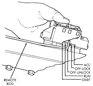

HOrnbrod Posted December 28, 2017 Posted December 28, 2017 Crap, another Photosuckit casualty. This is the ignition switch alignment procedure: Fig. 2: Ignition switch rod positioning On non-tilt columns: Move the ignition switch slider to the OFF unlocked position (move the slider all the way down, then back two clicks). The remote rod hole in the ignition switch slider should now be centered. Insert the remote rod in the ignition switch slider hole and install the ignition switch on the steering column. Tighten the attaching screws to 35 inch lbs. (4 Nm). On tilt columns: Insert the ignition key in the lock cylinder and turn the cylinder to the OFF unlocked position. Move the ignition switch downward to eliminate any slack and tighten the attaching screws to 35 inch lbs. (4 Nm). Install any components removed for switch access.
