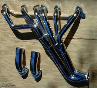

HOrnbrod Posted February 21, 2012 Author Posted February 21, 2012 Thanks Pat for that. (Poetry 101 :D ) I have quite a bit of clearance now on the down pipe from the x-member I think. The below is a pic of the header I use; no means to easily adjust it. But I think it will clear okay. I think this is a worthwhile mod. :cheers:
JeepcoMJ Posted February 21, 2012 Posted February 21, 2012 I think that header may be the exception lol. There may be a crossmember local to me. I will check. Another member here has just bought my last one along with an ax15. Ink double check the jy by me, though, if you'd like
