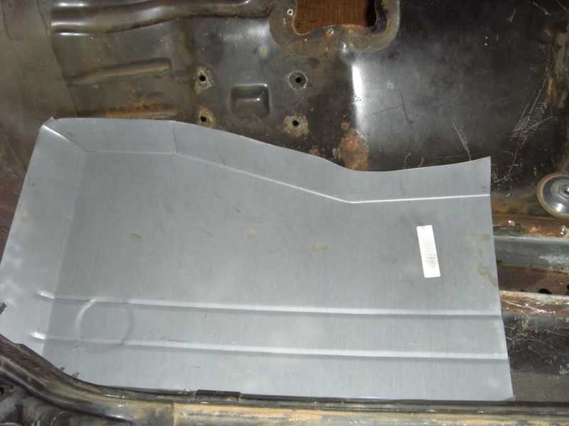

valis Posted March 7, 2011 Share Posted March 7, 2011 I just bought the front left pan through RockAuto.com and it was drop shipped from Classic2Current. I was expecting a much thinner piece of steel, but was pleasantly impressed when I pulled it out of the box. It fits decent enough that I can easily tack it in and seam seal it up. Keep in mind that in order to get it to fit properly without cutting it into pieces, you will need to remove the top of the frame rails that run from front to back in the Comanche cab. I can snap some pictures after work if you're interested. Link to comment Share on other sites More sharing options...

valis Posted March 8, 2011 Share Posted March 8, 2011 It's 18Ga. steel. Here are a few pictures of the front left floor pan: Link to comment Share on other sites More sharing options...
baldntatted Posted March 8, 2011 Share Posted March 8, 2011 18ga is some pretty thick stuff Link to comment Share on other sites More sharing options...
