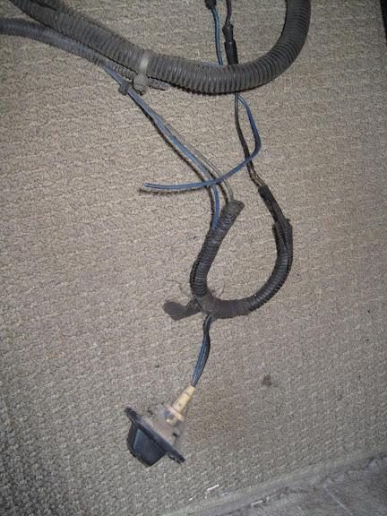

Unglar Posted August 22, 2010 Posted August 22, 2010 I pulled the rear harness off a JY MJ when I pulled the tail lights and it is still hooked up to the license plate light I can post a pic later.

Unglar Posted August 24, 2010 Posted August 24, 2010 Here is a pic of my harness, unfortunately one blue wire is cut... :-(
