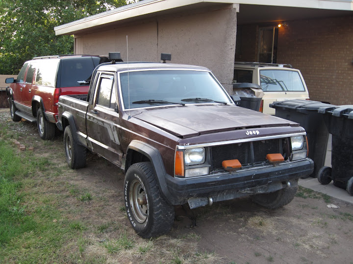

This is my $300 MJ with no tranny. It looks better the farther away you are.
The PO freaked when they told him how much to repair the pukegoat and he didnt even bother to get the broken one back.

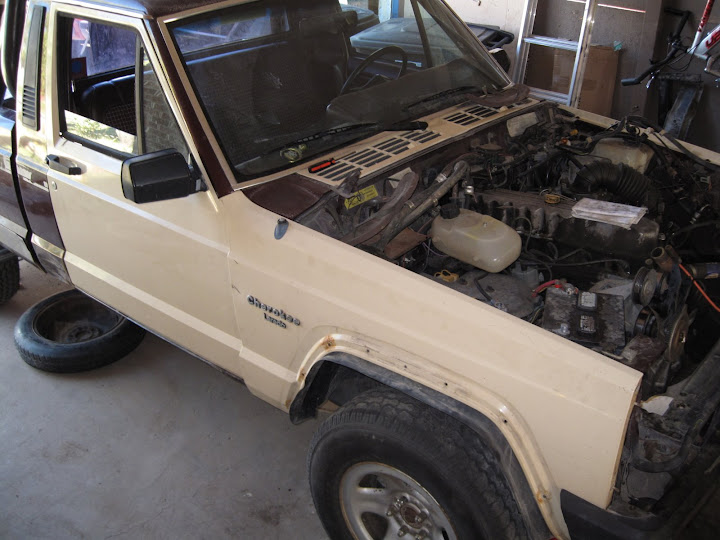

I figured it was a better use of my money as I need alot more than just a tranny. I still didn't really know what I was doing so my buddy told me to start by tearing apart the XJ. Here it is after a couple weeks:
I removed just about every thing that could be removed. I think the only thing left was the rear leafs and shocks, rear bumper and 1" hitch. I have sold $300-400 in parts so I easily made out on this deal. Not to mention learning alot about the XJ from the tear down.

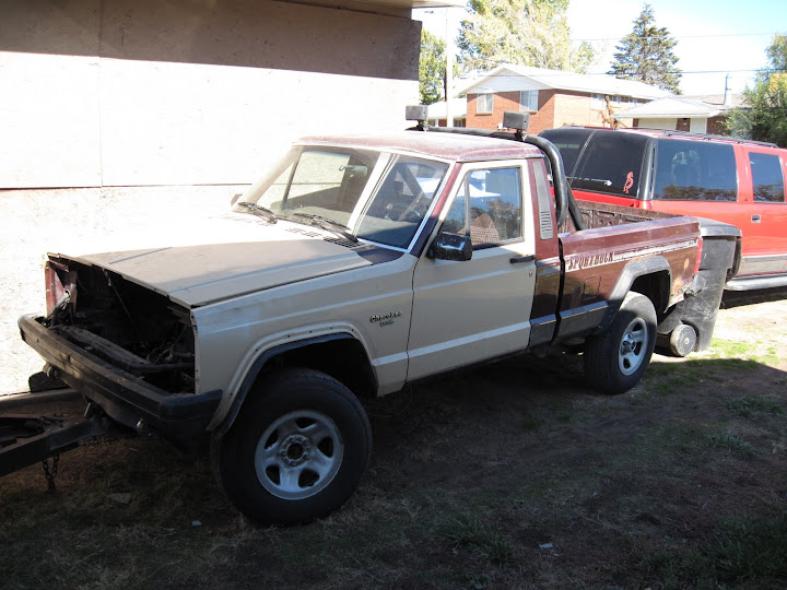

So, with the front bolt snapped off I decided to pull the MJ motor and go with the XJ motor, it ran ok when we drove it home about 45 miles. To pull the motor I needed to remove the radiator so I decided to replace the front clip while I was at it.

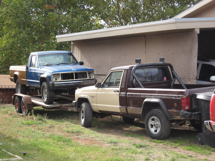

These are my donor parts:

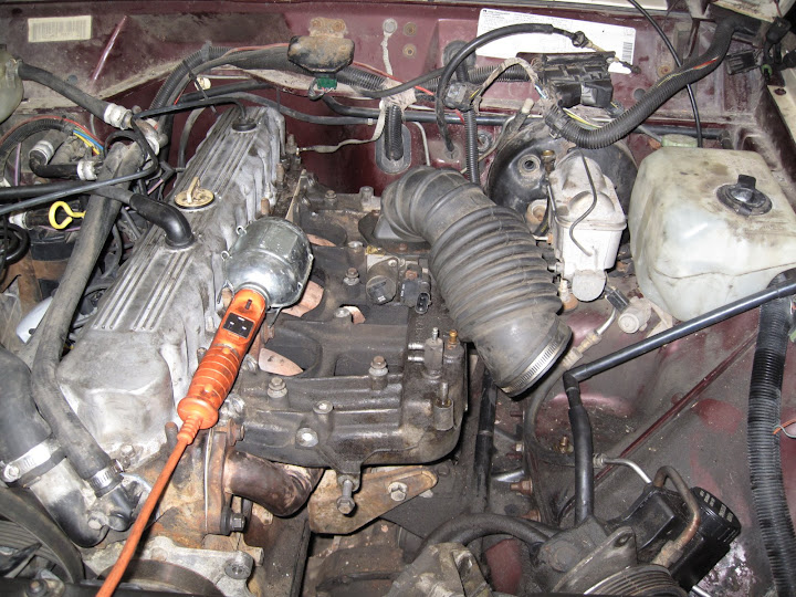

Thank you! So, when I got home from work I was all excited to fire it up. Hooked up the battery and cranked it over and it started but was making a weird noise, I thought it might have been because I didnt have the air cleaner housing hooked up. But when I was looking I noticed stuff coming off the belt.... As I was looking at the belt it started coming apart and I jumped back and shut it down! :hmm:
So i'm looking at the belt wondering what happened I notice a bolt laying on the belt and right against the timing notch. Doh! Note to self always check the belt after working on the rig....
Replaced the belt with a spare I had and double checked everywhere for stray bolts or tools. Then fired it up, it ran a bit rough so I shut it down and hooked up the air filter housing. Made sure all the vacuum tubes were hooked up right and started it back up. Purrs like a kitten! :banana:
Now I just need to hook up the clutch master to the slave and bleed the line. Then the drive shafts. :-)
