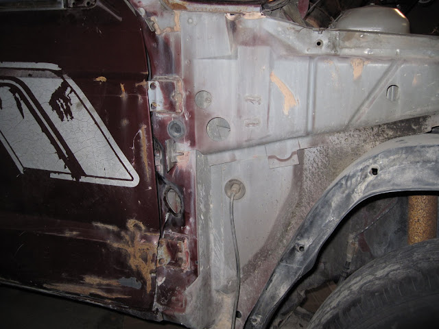

The A pillar is part of the unibody. I doubt very much you'll have much luck pulling it out. It would be better (and probably easier, believe it or not) to cut the corresponding section out of a wrecked Cherokee and weld it into your truck.
only way to do that is make the hinge not welded to the cab. call some bodyshops and ask what they would charge to pull it.
