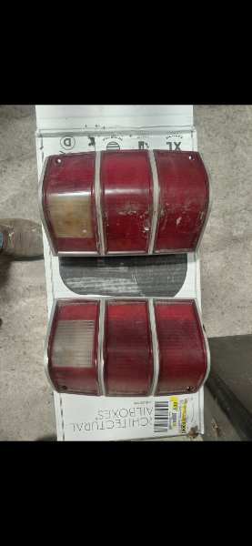

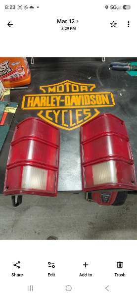

  1. Acquired these with a few trucks i bought but I went with a flatbed. $250.00 each pair includes s/h in lower 48
