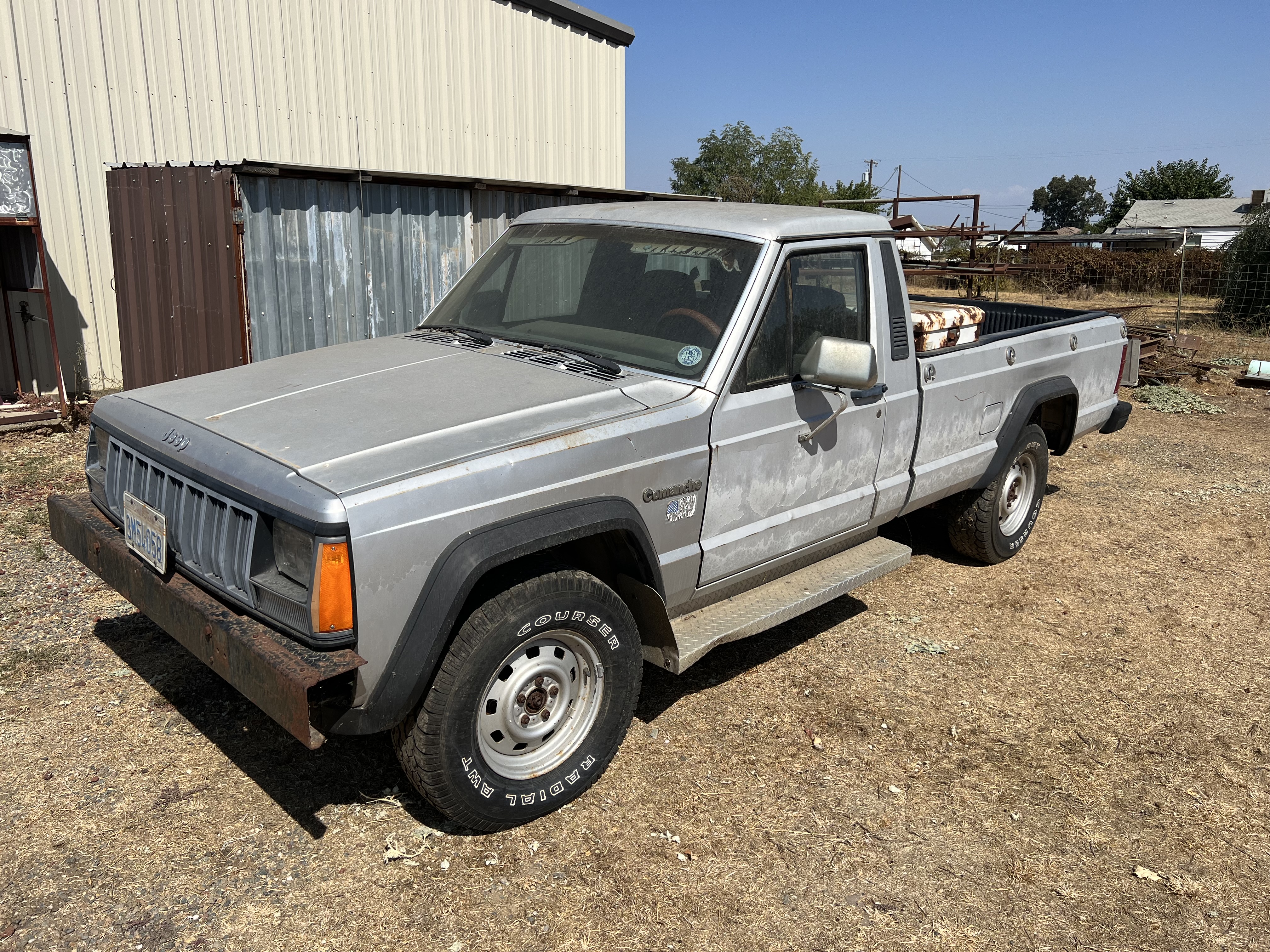

I made my first post over on the repair page so i guess i should post over here as well. Here’s a long winded write up on my 1988 4.0l 5spd 4x4 This truck belonged to a friend and mentor of mine who passed away about 10 years ago. A couple years ago another friend ended up with it and then needed to offload it. It appears he parked it about 20 years ago for unknown reasons as it was last registered in ‘05. Condition was unknown as my buddy had yet to do anything with it, but he was told it had transmission or transfer cases issues likely related to the crunch in the bed that came from moving a railroad baggage car 😂. So far i have found nothing to suggest any drivetrain problems other than me being a bit rusty driving a stick shift. So far i have done the following to it since i finally tore into it last month. Replaced battery, battery terminals, fuel, fuel pump, fuel filter, gas cap, all fuses, refreshed all grounds, cleaned C101 connector, cleaned distributor contacts (turned out to be basically new), spark plugs, all fuel rail o-rings (i took a gas bath when testing the new fuel pump…that was cool), fuel pressure regulator, water pump (see attached picture, the sound it made on first startup was…startling), idler pulley, serpentine belt, thermostat, coolant temp sensor, oil pressure sender, and god knows i have forgotten something. Known issues popping up are as follows, chime in with any tips if you care too - Brakes are about 5% functional (test drives have been fun 🙃) - Turn signals non-responsive - Vent/heat fan very weak - Back slider is missing - I don’t trust the coolant temp reading even after changing the sender (See repair board thread) - Resistance/popping in suspension/steering linkage during hard turns - Windshield leaking….somewhere?
