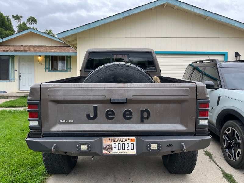

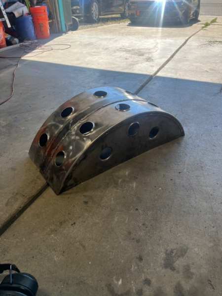

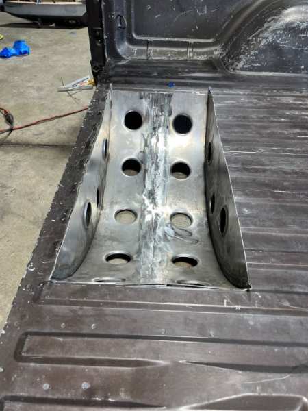

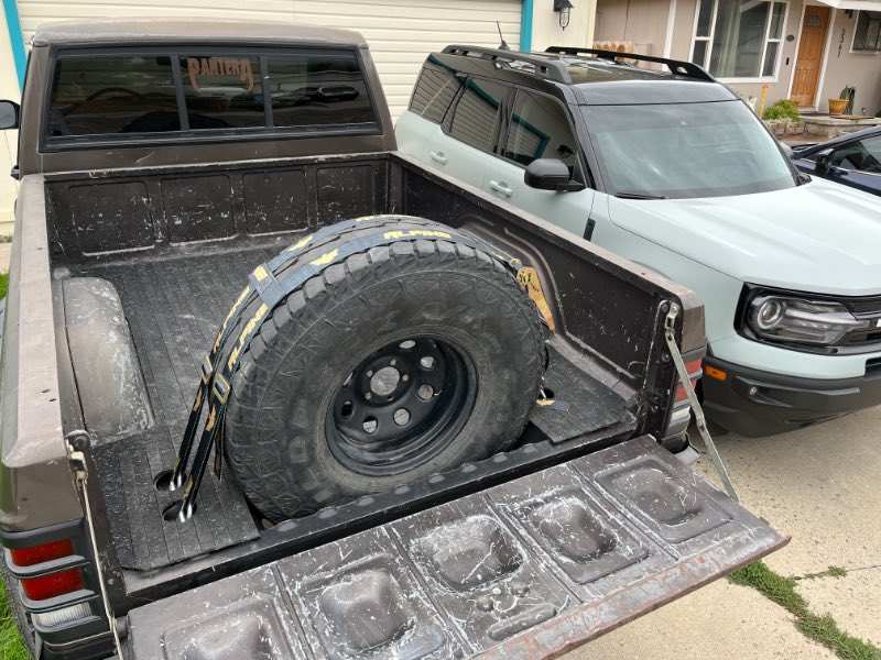

  4. Before paint I had decided to utilize some dead space under the bed and make a little spare tire carrier, it’s made from two 36” trailor fenders with dimples for rigidity and cool points. It gets the 35” tire to sit 9.5” lower. I also modified the piece of bed that I cut out it be able to drop back in and make the bed normal if I didn’t want to carry the tire for whatever reason. The extra weight behind the rear axle made a noticeable difference off-road and in the snow.

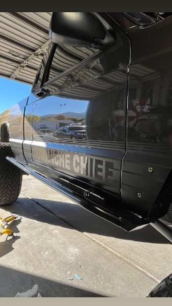

  5. I guess I need to post more to use the classifieds so I figured I’d add some more photos. Ended up repainting the rig and redoing the chief graphics.

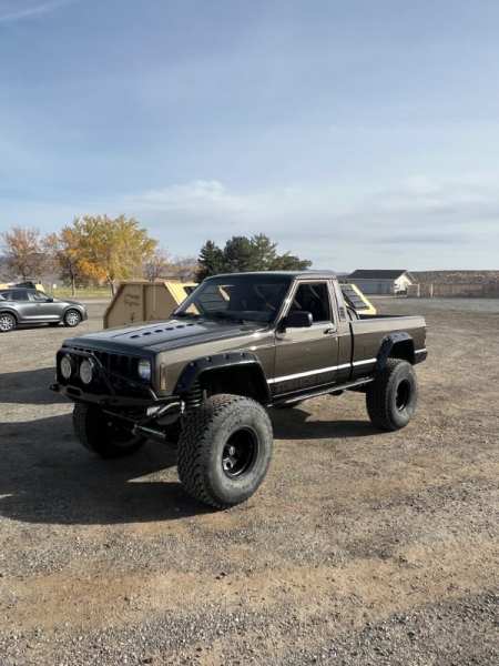

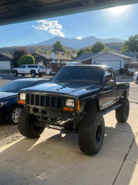

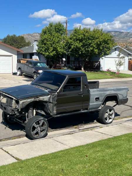

  6. I appreciate the help! I did find a website with the amc paint codes!
