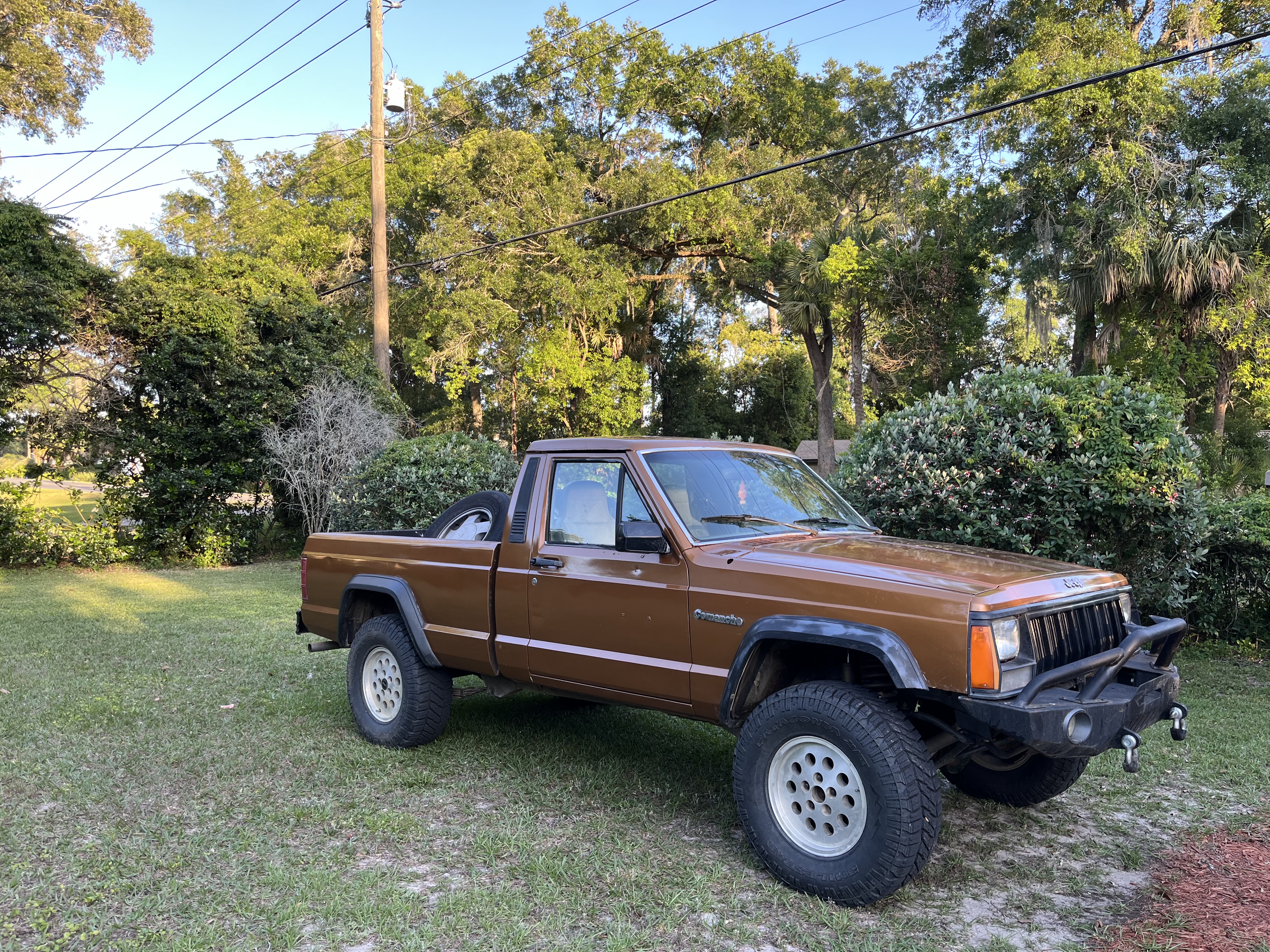

1987 Jeep Comanche 4.0 Inline 6 / (Believed to be) BA - 10. I have not verified / Dana 35 and short wheel base 2 wheel drive. did not see a build date in the door. Still on the road here in Central Florida. Was purchased by a buddy of mine who is fixing some of the smaller issues. Currently having the cooling system changed to open style due to issues with the original closed style. This is the only photo i got so far of it. Red exterior which looks like it was repainted. Under the interior it does appear to have been originally red though. Had burgundy carpet interior that has since been painted black. Has a bench seat as well.
