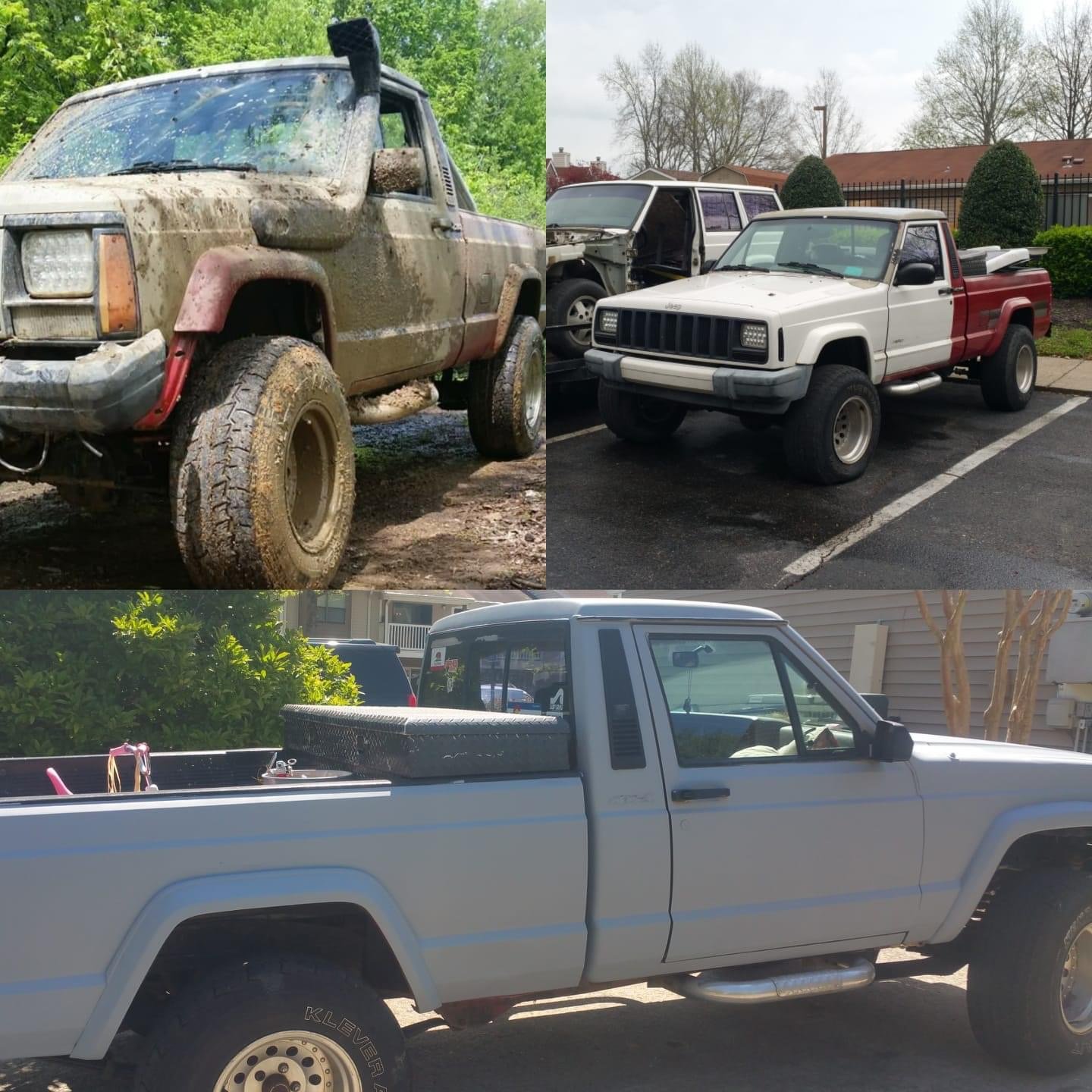

  1. Been super busy with work and family but I did get a few more things done. Snorkel hole back in fender well after the 2001 front end conversion and valve cover cleaned up to patina finish. Plus the intake crossover tub is painted to match the turbo but dropping the tdo4 to go Hx30/hx40 compounds.

  3. It’s a 4B3.3T making 74HP factory. Inline four cylinder turbo diesel. Mating it to the AX-15 transmission. Sorry for the photo of the plate. Seems Cummins skimps on one thing… it’s the identification tag for these things, and getting a new one is like pulling teeth I hear.
  4. Couple shots of me cleaning the bay/valve cover to paint. I love the patina look tho. Might just clean it all up and clear coat it. Same with the valve cover. Anyone have experience with their battery spilling acid and causing rust under the tray? Previous owner had no regard it seems. Glad that’s the only rust on the whole truck.
