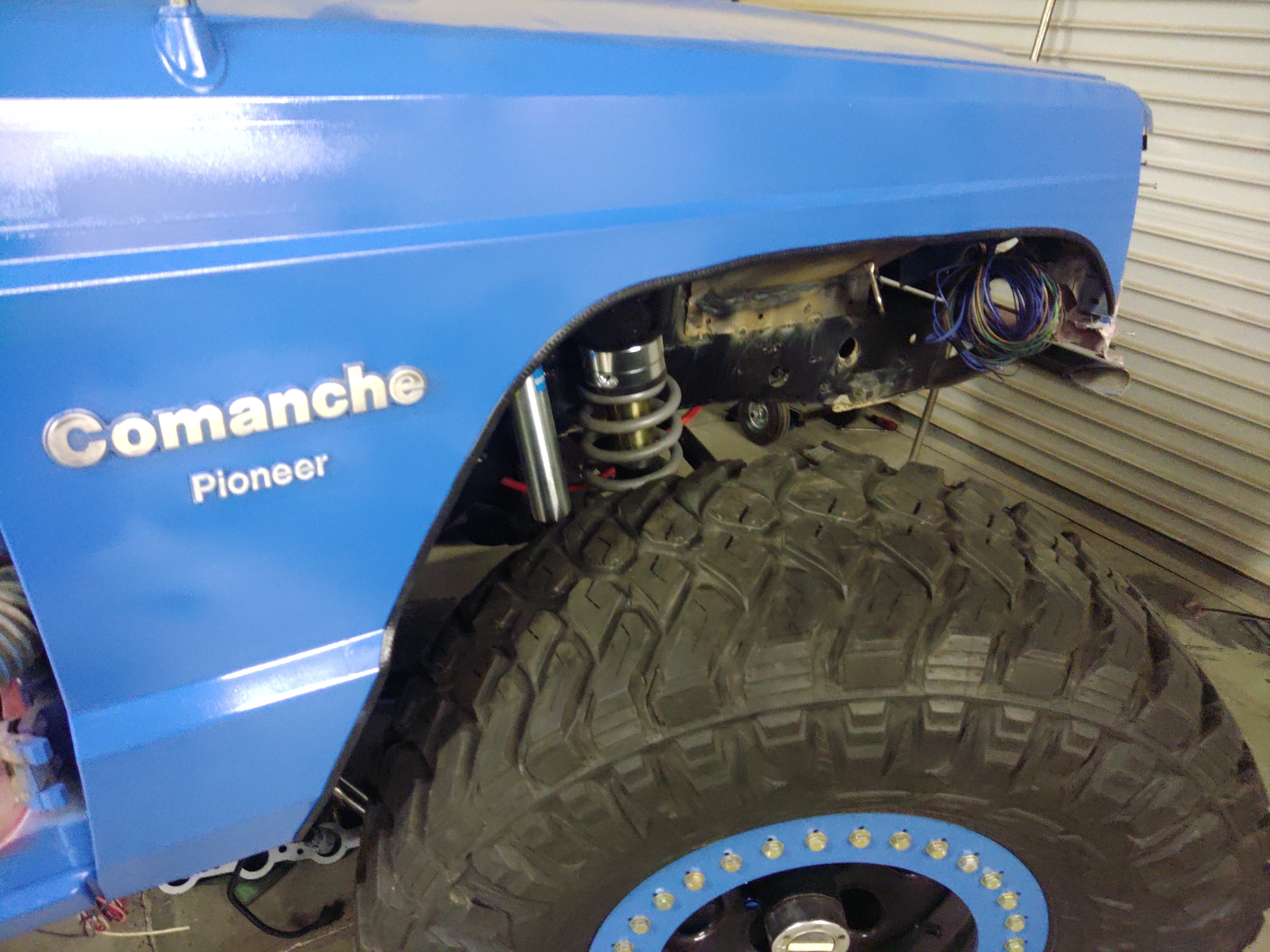

    Thomasyingling

    Here's some pictures of My truck that I like. It's my first build and my dream truck.

  3. So... I've heard mixed reviews on replacing the rocker panels with rectangular tubing, "Now it might as well be an xj", "you could have sold the cab corners if you were going to ruin them" and so on. As much as I love these trucks, I want to turn everything and your mom's minivan into an off-road machine. So, taking all the love and hate with a grain of salt, I cut the bottom corner of my perfectly good MJ cab off and welded in some 2x5 rectangular tubing. I would like to talk about the pros outweighing the cons on this particular topic. The cons For some, this ruins the classic look of the truck and fuel on the fire is It isn't one of the parts that can be replaced by XJ parts. Adds weight to the vehicle causing extra stress on important components. Can never easily return to being a purist Jeep Comanche, effectively eliminating the vehicle from being one of the rare trucks left. The Pros I believe the beefy rock boxes make the truck look better and is not only a performance upgrade, but a cosmetic enhancement. Of course, It does add weight to the truck, especially after adding bracing, cage and stiffeners to the sliders after the fact, but in combo with an LS or stroker, and some already needed bigger axles, the extra weight seems to matter less and less. I'm not sure taking rare trucks away from the fleet Is a bad thing. Although I am also sad to see them go, I have to assume that makes the Purists Jeep MJs even more rare and valuable. A bit controversial but if you ask me, if we are proud that our trucks are rare, we should thank the few people who give us more to be proud of. Just my opinion. rocker replacement boxes stiffen the frame when installed in combination with rock sliders, 4 link brackets, plating and just plain unibody. Allows a mounting point for and exo-cage to be mounted to project what is left of the rare truck cab. Safe but even more so is... Most importantly, it is a good foundation to weld an interior, hybrid cage to keep the driver and passenger safe. Of course, and as always, it matters what an individual is planning to do with the truck. If it is all the same to anyone else, a truck that is going to rock crawl or other rowdy activities will look much better with rock sliders and a cage than a smashed-up truck that left in its purist form. If a person intends to drive the truck to work, sporting a piece of history that he/she can be proud of, I would be the first to restore it down to the original decals and tire size. I Upload a new video every Monday morning to My YouTube channel. At the time of this post, this is my current project in preparation for the xofab cage I plan on modifying next year. www.youtube.com/@BlackAndBlueGarage Please let me know if you would like a Post per video starting from a year ago, I would love to get insight and criticism from the community. I am always excited to rap ideas and shade tree engineering.
