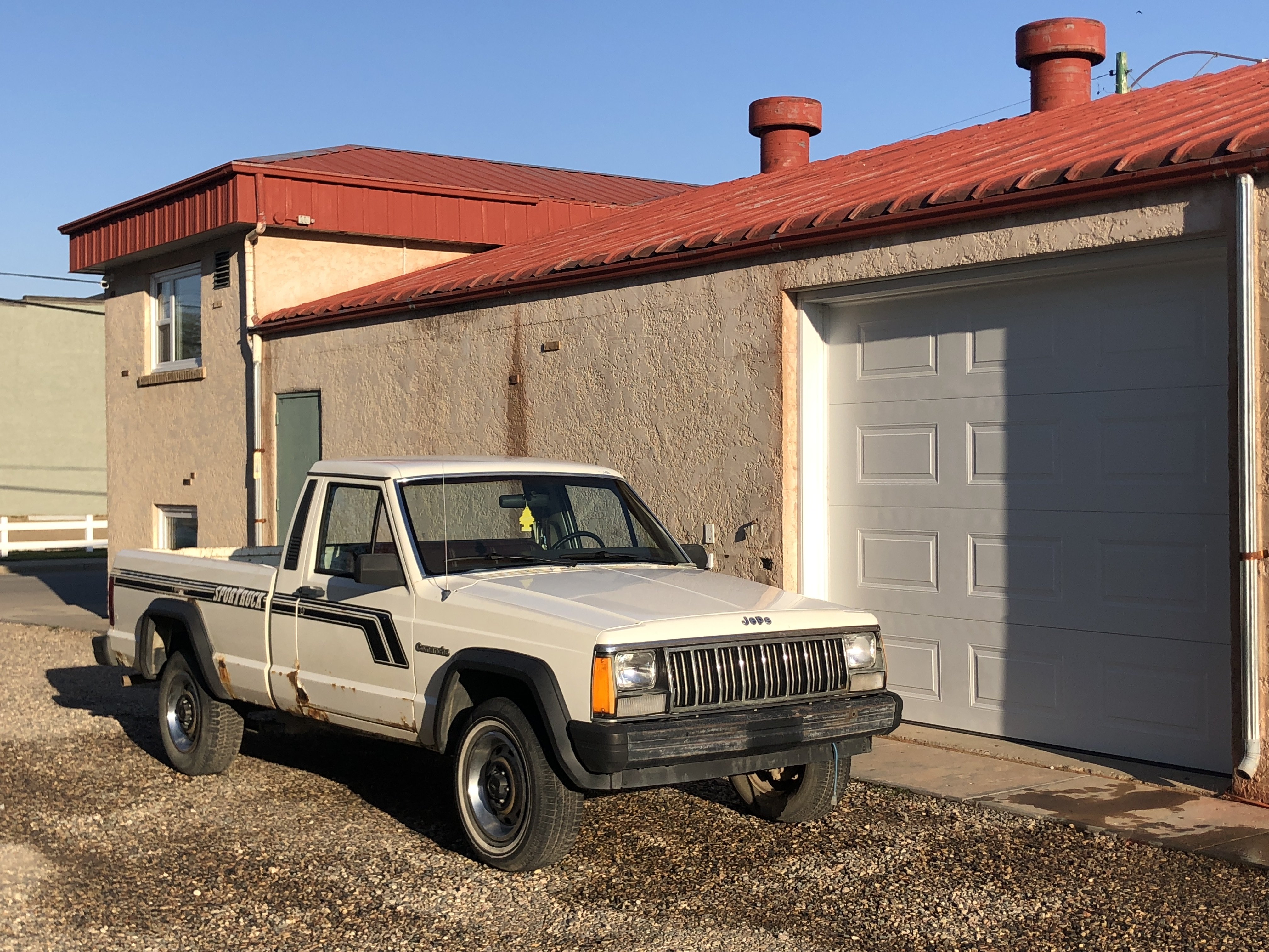

  1. This sounds very similar to my problem. I’m not an expert, this is my first jeep, so I can’t really give you insights about which parts are good or which have problems, but I’d like to hear if a sturdier braided line would do anything against it. Keep us posted.
