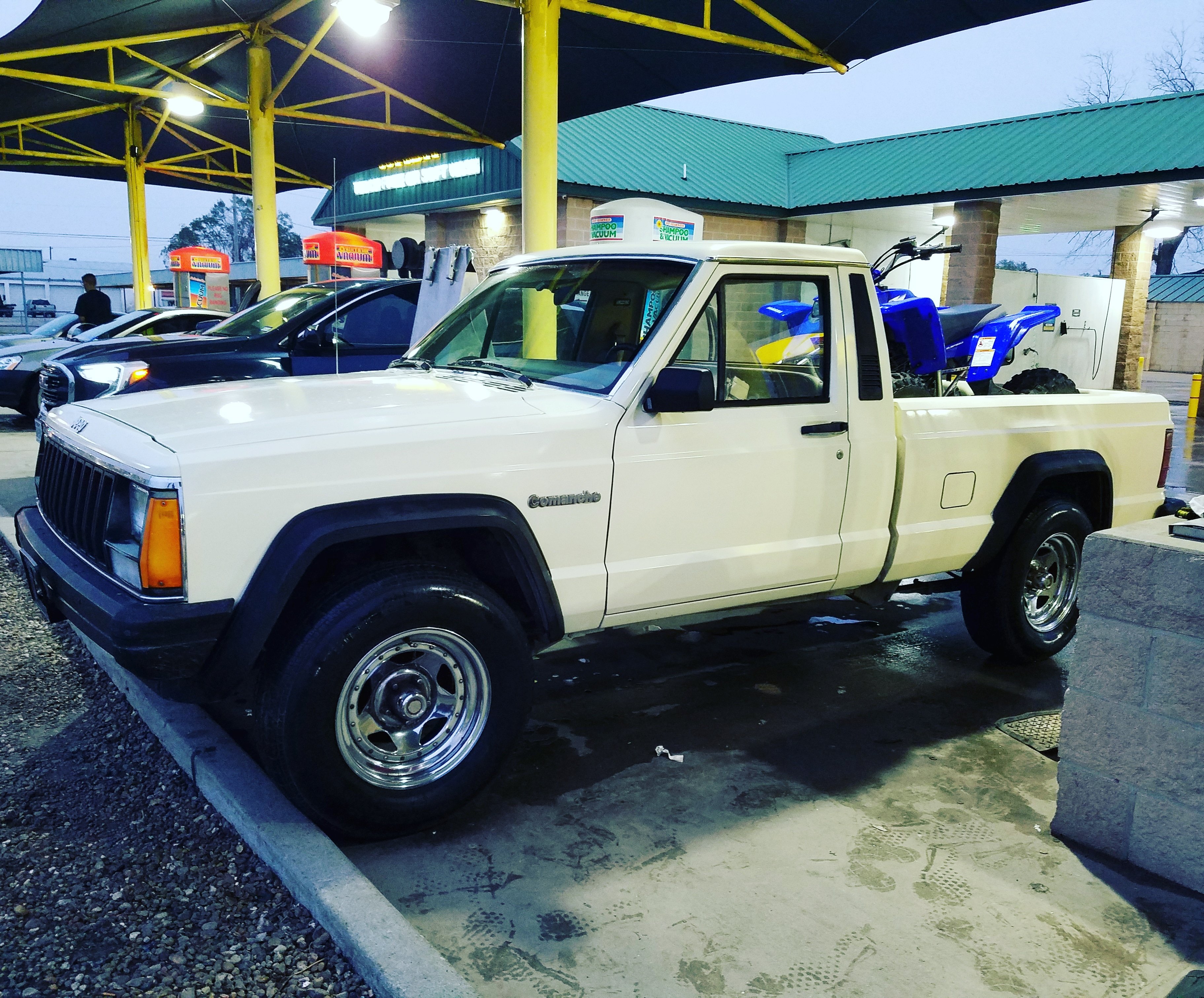

    My 87 swb, 2wd, factory 2.5/ aw4 with column shifter, cold factory AC.
