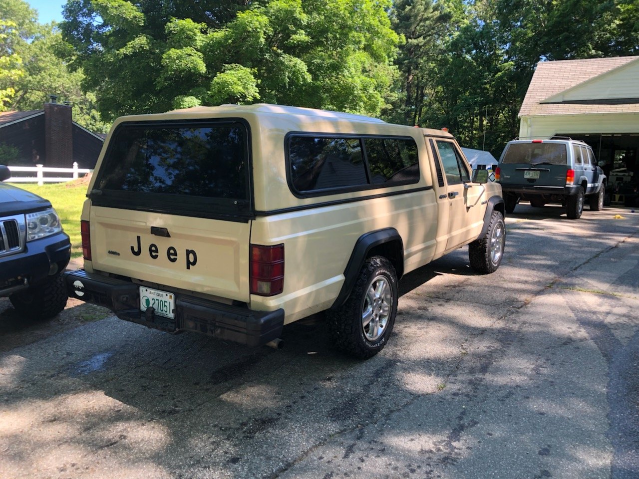

  2. Had some Overland rims with nearly new rubber laying around so I put them on... chrome might be a bit much for this truck but I'll do for now.

  7. About me: My first car was a '96 4.0 ZJ and I've been a Jeep fan ever since. Over the years I've owned a number of jeeps: '89 TJ 2.5, '85 CJ7 304, '04 WJ 4.0, '00 WJ 4.7, '88 MJ 2.5 and still have a n XJ, TJ and WJ. A few years ago I was set on buying a J20, but eventually I started looking at MJs. I picked up my first one a couple years ago ('88 sb rwd 2.5 144K miles) and fell in love with these trucks! In May of 2019, I scored an '89 LB from another MJ enthousiast and sold the '88. Would have loved to keep the short bed too but it was the only way to get the '89 home without being murdered by my wife (since I also own an '04 Overland WJ, '98 XJ, and an '02 TJ). About this thread: Starting this thread to track this build as it evolves over the months and years to come. This'll likely be a very slow project with the craziness of life (two young kids and house renovation in progress) but I don't plan on ever selling this truck so it'll be well worth it. I'm pretty green when it comes to working on my own rigs but over the last couple years I've been learning more. What I'm starting with: 1989 Long Bed 4.0 Auto 4x4 metric ton, color matched camper shell with 49,000 original miles! This truck has not been registered or inspected since 2010 and will need some serious love after sitting for so long. Overall, its really clean, original paint is in good shape and little rust underneath, the bad news is that the floors are completely gone and I've got some serious leaks that will need to be addressed. Other minor electrical and mechanical issues will need to be addressed before I can get her on the road but I'm super exited and feel lucky for what I have to start with!
