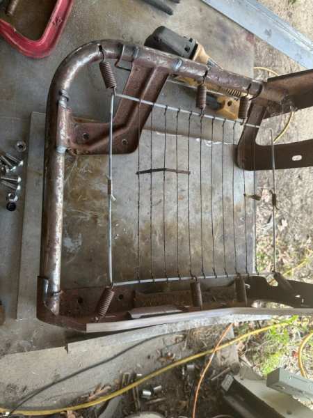

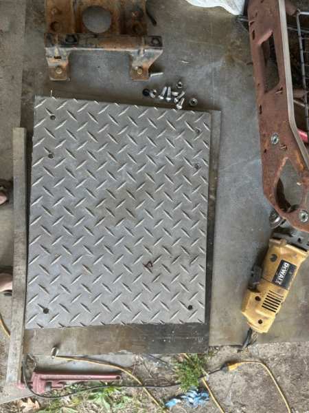

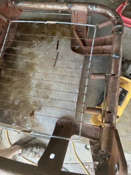

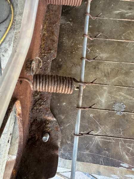

IMG_1309.jpeg.bf0ae2ba05d6a17cba8f972787c7ae12.jpegIMG_1311.jpeg.b7ff71eac26ee291dcad393a089398f0.jpegIMG_1311.jpeg.b7ff71eac26ee291dcad393a089398f0.jpeghere are some pics of what I did. Cut me a plate to mount to the seat frame. The old rocker slide were taken off the adjuster slide and I used that mechanism. Getting those rockers off is a pia cause one bolt is under the adjuster lever. I removed the front and rear bolt holding the rocker track on and spun the rocker slide basically unscrewing it. Then a finder and cut the bolt stem to get it out. The old rocker slide and the inside seat bolt line up almost perfect giving me the clearance side to side. That’s an old newer style frame I had laying about I’m using for test fitting etc. I also had to fold or bend the front lip up on the old style seat mount so it would meet the new seat since it’s flat and not concaved? Also ditch the 1/2” tubing for clearance as I didn’t need it. Probably gonna have to use something in the back to take out some seat incline. Not sure yet. I pretty much lay out when I drive so it may work great. Rain comin so done for now. If any of this is confusing I’ll be happy to clarify. But the basics are take the rocker mechanism off your old seat mount. Cut you a plate for the seat bottom. Match it to the holes in your seat frame and mate your old style sliders to the front inside bolt and buckle everything in. That center bolt on the lever side rocker is a serious b*@ch til I figures out just spin the rocker off and cut the bolt shaft to get it out. If this helps one person then I’m happy. Peace!
